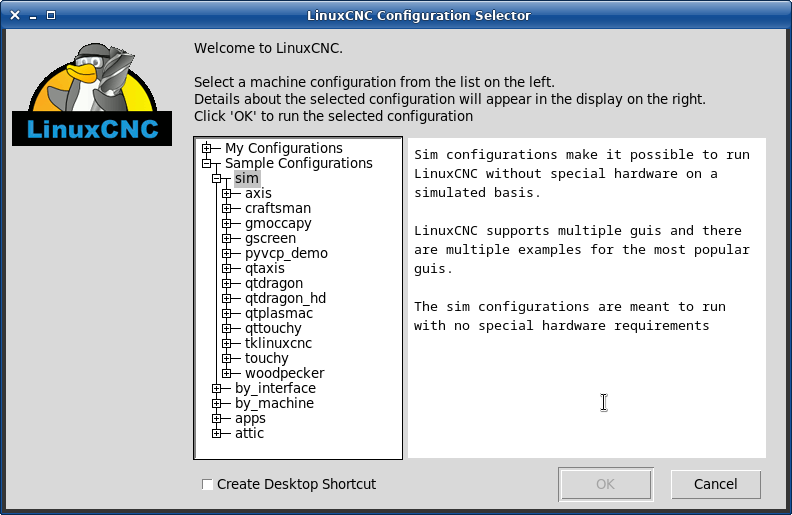

LinuxCNC Configuration Selector
Figur 1. LinuxCNC Configuration Selector
Click any of the listed configurations to display specific information about it. Double-click a configuration or click OK to start the configuration.
Select Create Desktop Shortcut and then click OK to add an icon on the Ubuntu desktop to directly launch this configuration without showing the Configuration Selector screen.
When you select a configuration from the Sample Configurations section, it will automatically place a copy of that config in the ~/linuxcnc/configs directory.
