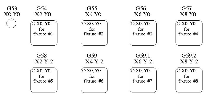

3. Coordinate Systems
Coordinate Systems Example
Figur 1. Coordinate Systems Example
Coordinate System Offsets
  • G54 - use coordinate system 1
  • G55 - use coordinate system 2
  • G56 - use coordinate system 3
  • G57 - use coordinate system 4
  • G58 - use coordinate system 5
  • G59 - use coordinate system 6
  • G59.1 - use coordinate system 7
  • G59.2 - use coordinate system 8
  • G59.3 - use coordinate system 9
Coordinate system offsets are used to shift the coordinate system from the machine coordinate system. This allows the G-code to be programmed for the part without regard to the part location on the machine. Using coordinate system offsets would allow you to machine parts in multiple locations with the same G-code.
The values for offsets are stored in the VAR file that is requested by the INI file during the startup of an LinuxCNC. In the example below, which uses G55, the position of each axis for G55 origin is stored in a numbered variable.
In the VAR file scheme, the first variable number stores the X offset, the second the Y offset and so on for all nine axes. There are numbered sets like this for each of the coordinate system offsets.
Each of the graphical interfaces has a way to set values for these offsets. You can also set these values by editing the VAR file itself and then restart LinuxCNC so that the LinuxCNC reads the new values however this is not the recommended way. Using G10, G52, G92, G28.1, etc are better ways to set the variables. For our example, we will directly edit the file so that G55 will take the following values:
