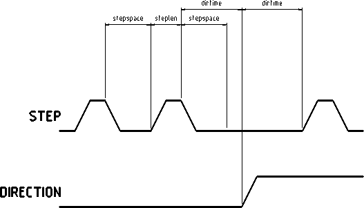

3.3. Step Waveform Timings
The firmware and driver enforce step length, space, and direction change times. Timings are rounded up to the next multiple of 1.6μs, with a maximum of 49.6μs. The timings are the same as for the software stepgen component, except that dirhold and dirsetup have been merged into a single parameter dirtime which should be the maximum of the two, and that the same step timings are always applied to all channels.
Pluto-Step Timings
Figur 3. Pluto-Step Timings
