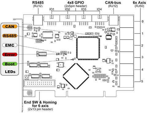

The following connectors can be found on the GM6-PCI card:
GM6-PCI card connectors and LEDs
Figur 1. GM6-PCI card connectors and LEDs
1. I/O connectors
Pin numbering of GPIO connectors
Figur 2. Pin numbering of GPIO connectors
Tabell 1. Pinout of GPIO connectors

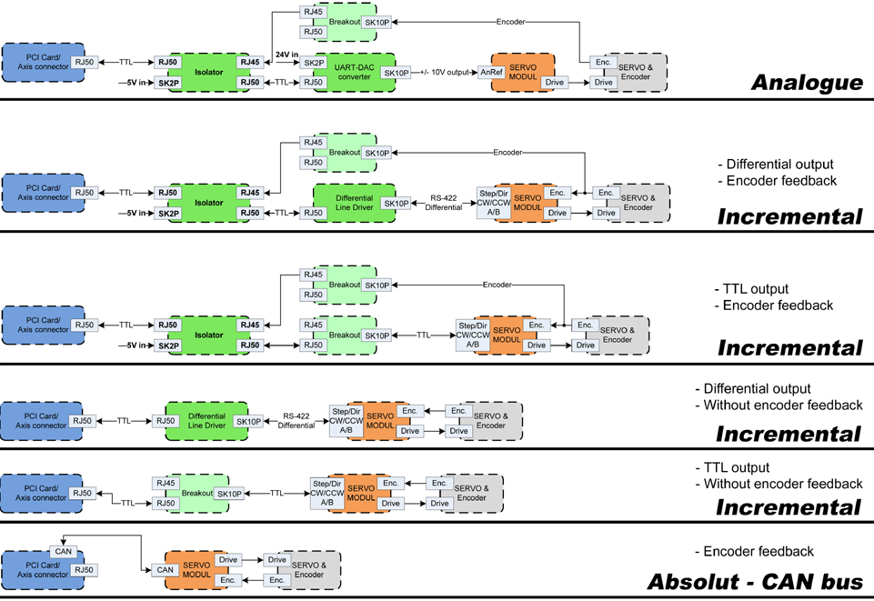

2.1. Axis interface modules
Small sized DIN rail mounted interface modules gives easy way of connecting different types of servo modules to the axis connectors. Seven different system configurations are presented in the System integration manual for evaluating typical applications. Also the detailed description of the Axis modules can be found in the System integration manual.
For evaluating the appropriate servo-drive structure the modules have to be connected as the following block diagram shows:
Servo axis interfaces
Figur 4. Servo axis interfaces

5. End-, homing- and E-stop switches
Pin numbering of homing and end switch connector
Figur 6. Pin numbering of homing & end switch connector
Tabell 16. End- and homing switch connector pinout
25 23 21 19 17 15 13 11 9 7 5 3 1
GND
1/End-
2/End+
2/Hom-ing
3/End-
4/End+
4/Hom-ing
5/End-
6/End+
6/Hom-ing
E-Stop 2
V+ (Ext.)
26 24 22 20 18 16 14 12 10 8 6 4 2
GND
1/End+
1/Hom-ing
2/End-
3/End+
3/Hom-ing
4/End-
5/End+
5/Hom-ing
6/End-
E-Stop 1
V+ (Ext.)
The GM6-PCI motion control card has two limit- and one homing switch input for each joint. All the names of these pins begin as follows:
gm.<card_no>.joint.<axis_no>
where <axis_no> is from 0 to 5. For example, gm.0.joint.0.home-sw-in indicates the state of the axis 0 home switch.
HAL pins are updated by function:

6. Status LEDs
6.1. CAN
Color: Orange
  • Blink, during data communication.
  • On, when any of the buffers are full - communication error.
  • Off, when no data communication.
6.2. RS485
Color: Orange
  • Blink, during initialization of modules on the bus
  • On, when the data communication is up between all initialized modules.
  • Off, when any of the initialized modules dropped off because of an error.
6.3. EMC
Color: White
  • Blink, when LinuxCNC is running.
  • Otherwise off.
6.4. Boot
Color: Green
  • On, when system booted successfully.
  • Otherwise off.
6.5. Error
Color: Red
  • Off, when there is no fault in the system.
  • Blink, when PCI communication error.
  • On, when watchdog timer overflowed.
