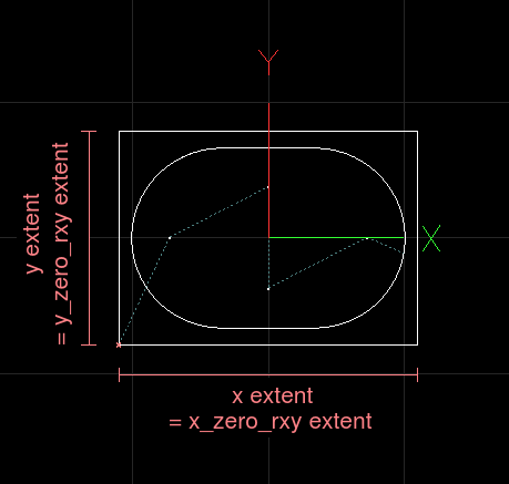

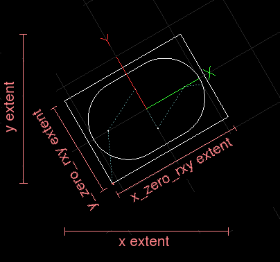

(returns Python dict) - Sent when G-code is loaded.
The dict contains the following keys:-
name(string): Name of the loaded file -
size(string): Size in bytes and lines -
g0(string): Total rapid distance -
g1(string): Total feed distance -
run(string): Estimated program run time -
toollist(list): List of used tools -
x(string): X extents (bounds) 1 -
x_zero_rxy(string): X extents without rotation around z (bounds) 1 -
y(string): Y extents (bounds) 1 -
y_zero_rxy(string): Y extents without rotation around z (bounds) 1 -
z(string): Z extents (bounds) 1 -
z_zero_rxy(string): Z extents without rotation around z (bounds) 1 -
machine_unit_sys(string): Machine units (Metric or Imperial) -
gcode_units(string): Units in G-code file (mm or in)
