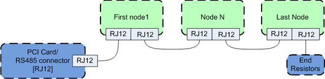

  • RS485 I/O expander modules: RS485 bus was designed for interfacing with compact DIN-rail mounted expander modules. An 8-channel digital input, an 8-channel relay output and an analogue I/O (4x +/-10 Volts output and 8x +/-5 Volts input) modules are available now. Up to 16 modules can be connected to the bus altogether.

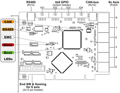

The following connectors can be found on the GM6-PCI card:
GM6-PCI card connectors and LEDs
Figure 1. GM6-PCI card connectors and LEDs
1. I/O connectors

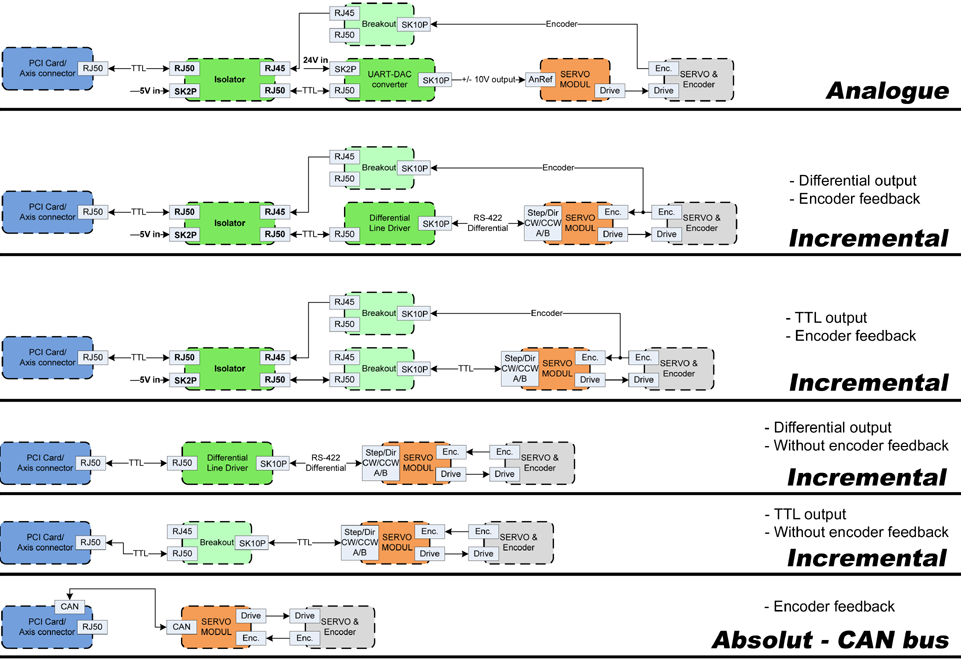

2.1. Axis interface modules
Small sized DIN rail mounted interface modules gives easy way of connecting different types of servo modules to the axis connectors. Seven different system configurations are presented in the System integration manual for evaluating typical applications. Also the detailed description of the Axis modules can be found in the System integration manual.
For evaluating the appropriate servo-drive structure the modules have to be connected as the following block diagram shows:
Servo axis interfaces
Figure 4. Servo axis interfaces

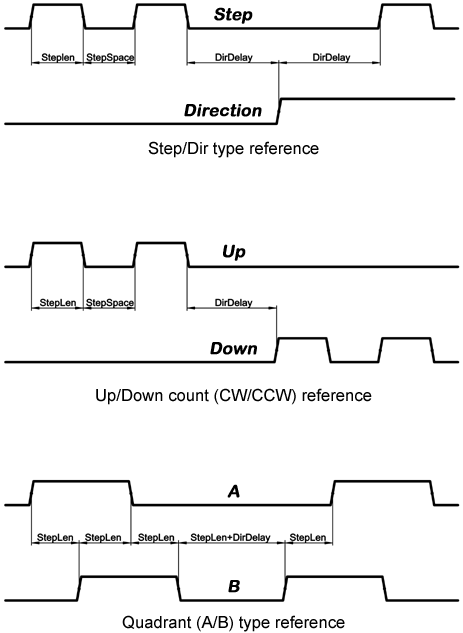

For evaluating the appropriate values see the timing diagrams below:
Reference signal timing diagrams
Figure 5. Reference signal timing diagrams

5. End-, homing- and E-stop switches
Pin numbering of homing and end switch connector
Figure 6. Pin numbering of homing & end switch connector
Table 16. End- and homing switch connector pinout
25 23 21 19 17 15 13 11 9 7 5 3 1
GND
1/End-
2/End+
2/Hom-ing
3/End-
4/End+
4/Hom-ing
5/End-
6/End+
6/Hom-ing
E-Stop 2
V+ (Ext.)
26 24 22 20 18 16 14 12 10 8 6 4 2
GND
1/End+
1/Hom-ing
2/End-
3/End+
3/Hom-ing
4/End-
5/End+
5/Hom-ing
6/End-
E-Stop 1
V+ (Ext.)
The GM6-PCI motion control card has two limit- and one homing switch input for each joint. All the names of these pins begin as follows:

Automatic node recognizing
Each node connected to the bus was recognized by the GM6-PCI card automatically. During starting LinuxCNC, the driver export pins and parameters of all available modules automatically.
Fault handling
If a module does not answer regularly the GM6-PCI card drops down the module. If a module with output do not gets data with correct CRC regularly, the module switch to error state (green LED blinking), and turns all outputs to error state.
Connecting the nodes
The modules on the bus have to be connected in serial topology, with termination resistors on the end. The start of the topology is the PCI card, and the end is the last module.
Connecting the RS485 nodes to the GM6-PCI card
Figure 7. Connecting the RS485 nodes to the GM6-PCI card
Addressing
Each node on the bus has a 4 bit unique address that can be set with a red DIP switch.
