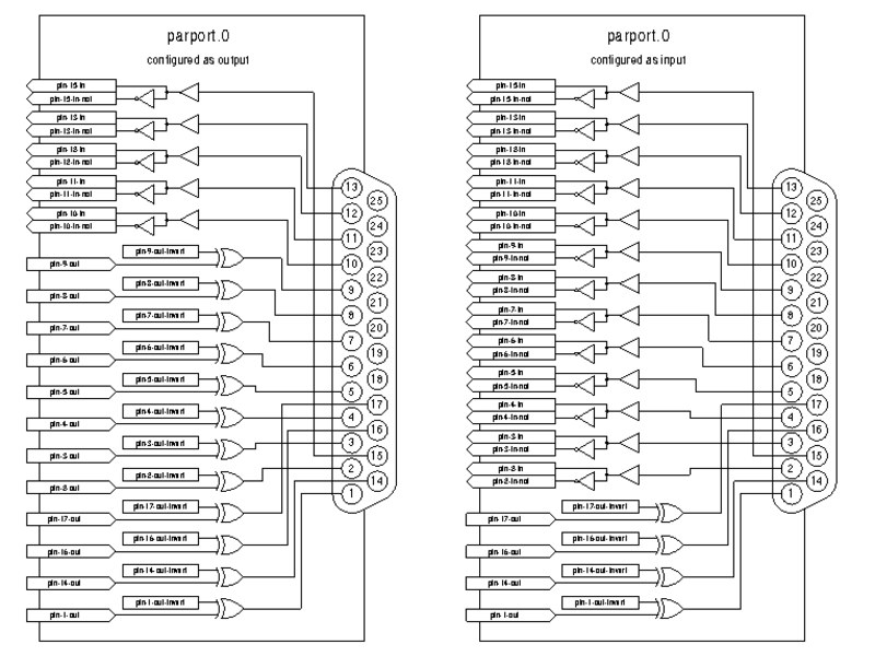

parport.<p>.pin-`__<n>__
-out` (bit) Drives a physical output pin. -
-in` (bit) Tracks a physical input pin. -
-in-not` (bit) Tracks a physical input pin, but inverted.
For each pin, <p> is the port number, and <n> is the physical pin number in the 25 pin D-shell connector.
For each physical output pin, the driver creates a single HAL pin, for example: parport.0.pin-14-out
For each physical input pin, the driver creates two HAL pins, for example: parport.0.pin-12-in
and parport.0.pin-12-in-not
The -in
HAL pin is TRUE if the physical pin is high, and FALSE if the physical pin is low. The -in-not
HAL pin is inverted and is FALSE if the physical pin is high.
4. Parameters
parport.`__<p>__
.pin-__<n>__
-out-invert` (bit) Inverts an output pin. -
parport.`__<p>__
.pin-__<n>__
-out-reset` (bit) (only for-out
pins) TRUE if this pin should be reset when the-reset
function is executed. -
parport.`__<p>__
.reset-time` (U32) The time (in nanoseconds) between a pin is set by-write
and reset by the-reset
function if it is enabled.
The -invert
parameter determines whether an output pin is active high or active low. If -invert
is FALSE, setting the HAL -out
pin TRUE drives the physical pin high, and FALSE drives it low. If -invert
is TRUE, then setting the HAL -out
pin TRUE will drive the physical pin low.
