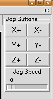

3. Jog Buttons Example

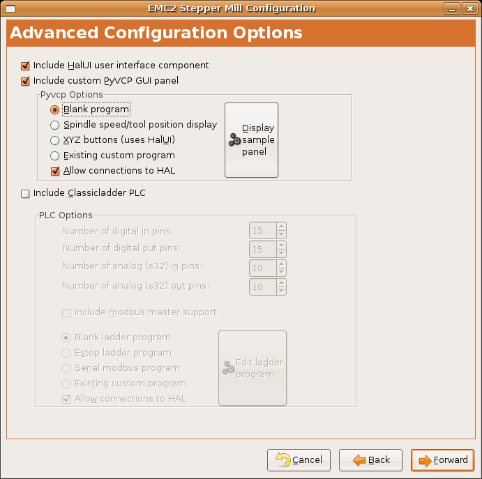

In this example we will create a PyVCP panel with jog buttons for X, Y, and Z. This configuration will be built upon a StepConf Wizard generated configuration. First we run the StepConf Wizard and configure our machine, on the Advanced Configuration Options page we then make a couple of selections to add a blank PyVCP panel as shown in the following figure. For this example we named the configuration pyvcp_xyz on the Basic Machine Information page of the StepConf Wizard.
PyVCP XYZ Wizard Configuration
The StepConf Wizard will create several files and place them in the linuxcnc/configs/pyvcp_xyz directory. If you left the create link checked you will have a link to those files on your desktop.

After adding the above you now will have a PyVCP panel that looks like the following attached to the right side of AXIS. It looks nice but it does not do anything until you connect the buttons to halui. If you get an error when you try and run scroll down to the bottom of the pop up window and usually the error is a spelling or syntax error and it will be there.
Jog Buttons Image

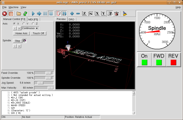

5. GS2 RPM Meter
The following example uses the Automation Direct GS2 VDF driver and displays the RPM and other info in a PyVCP panel. This example is based on the GS2 example in the Hardware Examples section this manual.
5.1. The Panel
To create the panel we add the following to the XML file.

The above gives us a PyVCP panel that looks like the following.
GS2 Panel

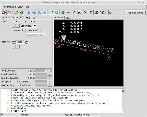

6. Rapid to Home Button
This example creates a button on the PyVCP side panel when pressed will send all the axis back to the home position. This example assumes you don’t have a PyVCP panel.
images/pyvcp-rth.png
In your configuration directory create the XML file. In this example it’s named rth.xml. In the rth.xml file add the following code to create the button.

Open your INI file with a text editor and in the [DISPLAY] section add the following line. This is what loads the PyVCP panel.
PYVCP = rth.xml
If you don’t have a [HALUI] section in the INI file create it and add the following MDI command.
MDI_COMMAND = G53 G0 X0 Y0 Z0
Information about G53 and G0 G-codes.
In the [HAL] section if you don’t have a post gui file add the following and create a file called postgui.hal.
POSTGUI_HALFILE = postgui.hal
In the postgui.hal file add the following code to link the PyVCP button to the MDI command.
net rth halui.mdi-command-00 <= pyvcp.rth-button
Information about the net command
