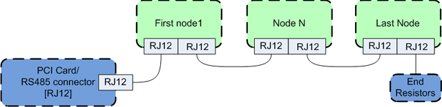

RS485 I/O expander modules: RS485 bus was designed for interfacing with compact DIN-rail mounted expander modules. An 8-channel digital input, an 8-channel relay output and an analogue I/O (4x +/-10 Volts output and 8x +/-5 Volts input) modules are available now. Up to 16 modules can be connected to the bus altogether.

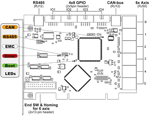

The following connectors can be found on the GM6-PCI card:
1. I/O connectors
9 | 7 | 5 | 3 | 1 |
IOx/7 |
IOx/5 |
IOx/3 |
IOx/1 |
VCC |
10 | 8 | 6 | 4 | 2 |
GND |
IOx/6 |
IOx/4 |
IOx/2 |
IOx/0 |
Each pin can be configured as digital input or output. GM6-PCI motion control card has 4 general purpose I/O (GPIO) connectors, with eight configurable I/O on each. Every GPIO pin and parameter name begins as follows:

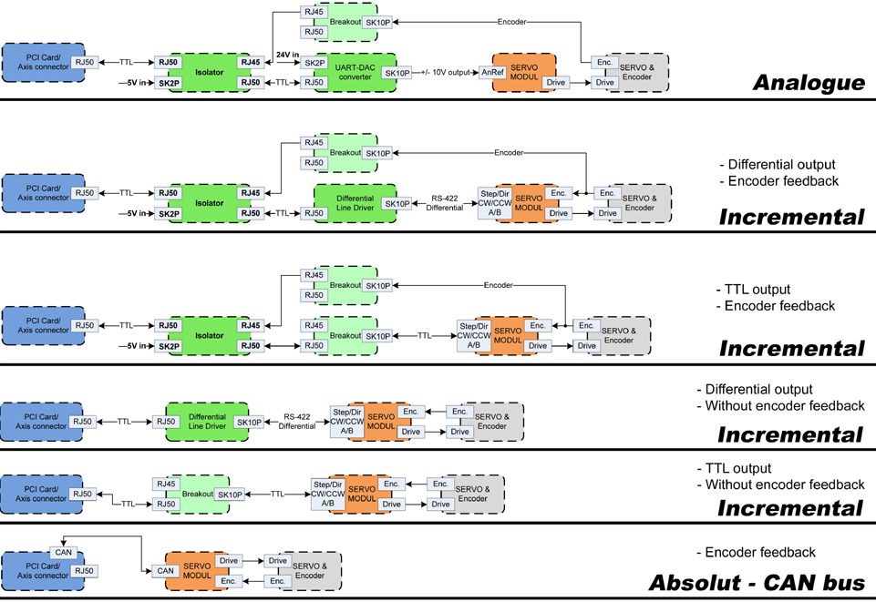

2.1. Axis interface modules
Small sized DIN rail mounted interface modules gives easy way of connecting different types of servo modules to the axis connectors. Seven different system configurations are presented in the System integration manual for evaluating typical applications. Also the detailed description of the Axis modules can be found in the System integration manual.
For evaluating the appropriate servo-drive structure the modules have to be connected as the following block diagram shows:

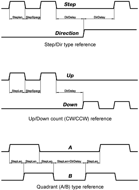

Length of step pulse in nano-seconds. |
(u32, R/W) |
Minimum time between two step pulses in nano-seconds. |
(u32, R/W) |
Minimum time between step pulse and direction change in nanoseconds. |
For evaluating the appropriate values see the timing diagrams below:

6. Status LEDs
6.1. CAN
Color: Orange
Blink, during data communication.
On, when any of the buffers are full - communication error.
Off, when no data communication.
6.2. RS485
Color: Orange
Blink, during initialization of modules on the bus
On, when the data communication is up between all initialized modules.

6.5. Error
Color: Red
Off, when there is no fault in the system.
Blink, when PCI communication error.
On, when watchdog timer overflowed.
7. RS485 I/O expander modules
These modules were developed for expanding the I/O and function capability along an RS485 line of the GM6-PCI motion control card.
Available module types:
8-channel relay output module - gives eight NO-NC relay output on a three pole terminal connector for each channel.
8-channel digital input module - gives eight optical isolated digital input pins.
8 channel ADC and 4-channel DAC module - gives four digital-to-analogue converter outputs and eight analogue-to-digital inputs. This module is also optically isolated from the GM6-PCI card.
Each node connected to the bus was recognized by the GM6-PCI card automatically. During starting LinuxCNC, the driver export pins and parameters of all available modules automatically.
If a module does not answer regularly the GM6-PCI card drops down the module. If a module with output do not gets data with correct CRC regularly, the module switch to error state (green LED blinking), and turns all outputs to error state.
The modules on the bus have to be connected in serial topology, with termination resistors on the end. The start of the topology is the PCI card, and the end is the last module.
Each node on the bus has a 4 bit unique address that can be set with a red DIP switch.
A green LED indicates the status of the module:
Blink, when the module is only powered, but not jet identified, or when module is dropped down.
Off, during identification (computer is on, but LinuxCNC not started)
On, when it communicates continuously.

8. Errata
8.1. GM6-PCI card Errata
The revision number in this section refers to the revision of the GM6-PCI card device.
Error: The PCI card do not boot, when Axis 1. END B switch is active (low). Found on November 16, 2013.
Reason: This switch is connected to a boot setting pin of FPGA
Problem fix/workaround: Use other switch pin, or connect only normally open switch to this switch input pin.
