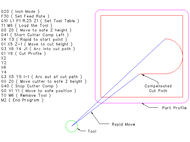

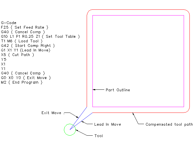

Start a program with G40 to make sure compensation is off.
4.2. Examples
4.2.1. Outside Profile Example
4.2.2. Inside Profile Example
