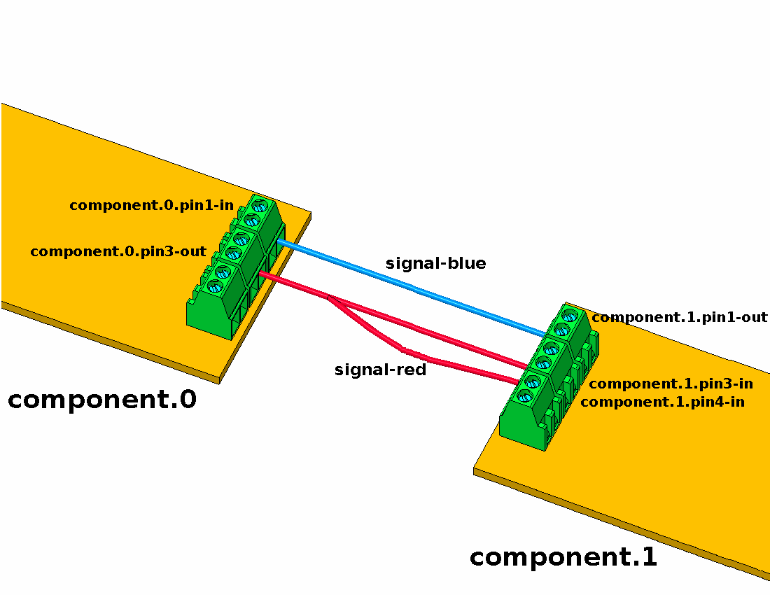

HAL Circuit Concept
Figure 1. HAL Concept - Connecting like elctrical circuits.
Figure one would be written in HAL code like this:
net signal-blue    component.0.pin1-in      component.1.pin1-out
net signal-red     component.0.pin3-out     component.1.pin3-in     component.1.pin4-in
