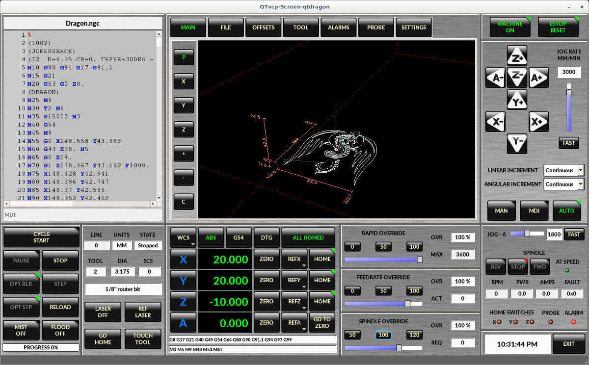

QTDragon Router
Figure 1. qtdragon - 3 or 4 Axis Sample

The sample configuration sim/qtvcp_screens/qtdragon/qtdragon_xyza.ini is already configured to use SilverDragon as its front-end.
There are several others, to demonstrate different machine configurations.

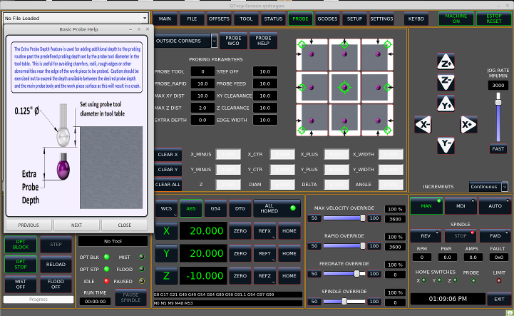

10. Probing
The probe screen has been through basic testing but there could still be some minor bugs. When running probing routines, use extreme caution until you are familiar with how everything works. Probe routines run without blocking the main GUI. This gives the operator the opportunity to watch the DROs and stop the routine at any time.
Note
Probing is very unforgiving to mistakes; be sure to check settings before using.
QTDragon Probe
Figure 2. qtdragon - Probe Sample
QtDragon has 2 possible methods for setting Z0. The first is a touchplate, where a metal plate of known thickness is placed on top of the workpiece and then the tool is lowered until it touches the plate, triggering the probe signal. Z0 is set to probe height - plate thickness.
The second method uses a tool setter in a fixed position and a known height above the table where the probe signal will be triggered. In order to set Z0 to the top of the workpiece, it has to know how far above the table the probe trigger point is (tool setter height) and how far above the table the top of the workpiece is. This operation has to be done every time the tool is changed as the tool length is not saved.
For touching off with a touch probe, whether you use the touchplate operation with thickness set to 0 or use a probing routine, the height from table to top of workpiece parameter is not taken into account and can be ignored. It is only for the tool setter.

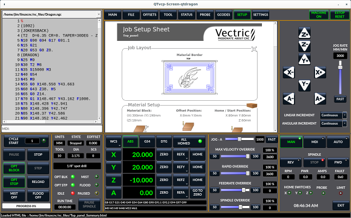

13. Setup Tab
It’s possible to load Html file (.html ending) with setup notes. They will be displayed in the setup tab.
Some program, such as Fusion and Aspire will create this files for you.
QTDragon Setup Tab
Figure 3. qtdragon - Setup Tab Sample
