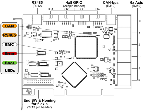

General Mechatronics GM6-PCI card based motion control system
For detailed description, please refer to the System integration manual.
The GM6-PCI motion control card is based on an FPGA and a PCI bridge interface ASIC. A small automated manufacturing cell can be controlled, with a short time system integration procedure. The following figure demonstrating the typical connection of devices related to the control system:
It can control up to six axis, each can be stepper or CAN bus interface or analogue servo.
GPIO: Four time eight I/O pins are placed on standard flat cable headers.

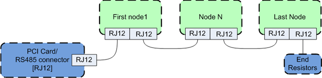

RS485 I/O expander modules: RS485 bus was designed for interfacing with compact DIN-rail mounted expander modules. An 8-channel digital input, an 8-channel relay output and an analogue I/O (4x +/-10 Volts output and 8x +/-5 Volts input) modules are available now. Up to 16 modules can be connected to the bus altogether.

The following connectors can be found on the GM6-PCI card:
1. I/O connectors
| 9 | 7 | 5 | 3 | 1 |
IOx/7  |
IOx/5  |
IOx/3  |
IOx/1  |
VCC  |
| 10 | 8 | 6 | 4 | 2 |
GND  |
IOx/6  |
IOx/4  |
IOx/2  |
IOx/0  |

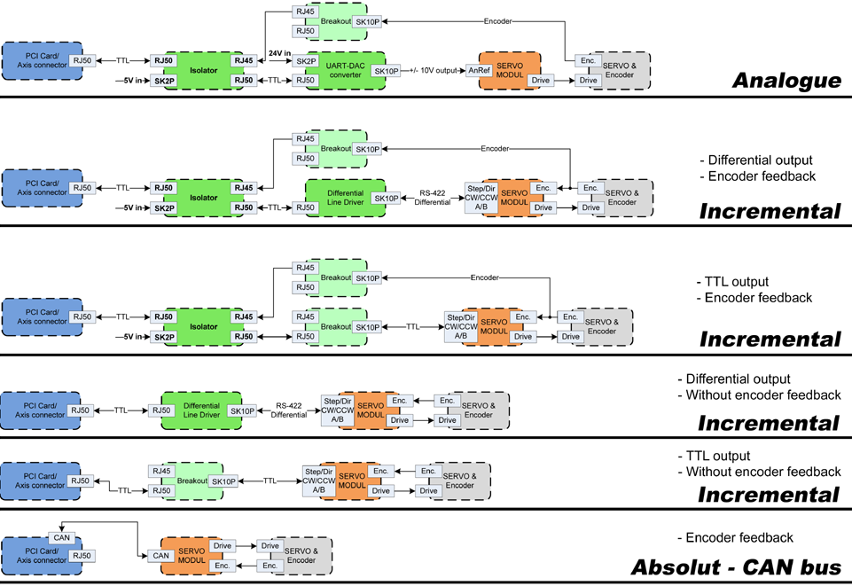

2.1. Axis interface modules
Small sized DIN rail mounted interface modules gives easy way of connecting different types of servo modules to the axis connectors. Seven different system configurations are presented in the System integration manual for evaluating typical applications. Also the detailed description of the Axis modules can be found in the System integration manual.
For evaluating the appropriate servo-drive structure the modules have to be connected as the following block diagram shows:

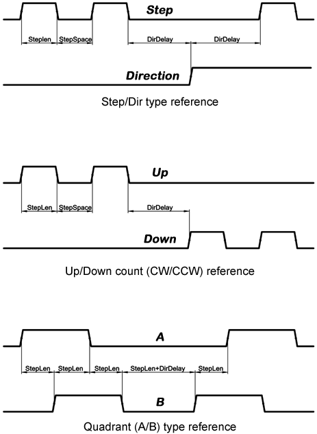

.steplen  |
(u32, R/W)  |
Length of step pulse in nano-seconds.  |
.stepspace  |
(u32, R/W)  |
Minimum time between two step pulses in nano-seconds.  |
.dirdelay  |
(u32, R/W)  |
Minimum time between step pulse and direction change in nano-seconds.  |
For evaluating the appropriate values see the timing diagrams below:

5. End-, homing- and E-stop switches
| 25 | 23 | 21 | 19 | 17 | 15 | 13 | 11 | 9 | 7 | 5 | 3 | 1 |
GND  |
1/End-  |
2/End+  |
2/Hom-ing  |
3/End-  |
4/End+  |
4/Hom-ing  |
5/End-  |
6/End+  |
6/Hom-ing  |
E-Stop 2  |
V+ (Ext.)  |
| 26 | 24 | 22 | 20 | 18 | 16 | 14 | 12 | 10 | 8 | 6 | 4 | 2 |
GND  |
1/End+  |
1/Hom-ing  |
2/End-  |
3/End+  |
3/Hom-ing  |
4/End-  |
5/End+  |
5/Hom-ing  |
6/End-  |
E-Stop 1  |
V+ (Ext.)  |
The GM6-PCI motion control card has two limit- and one homing switch input for each joint. All the names of these pins begin as follows:

6. Status LEDs
6.1. CAN
Color: Orange
Blink, during data communication.
On, when any of the buffers are full - communication error.
Off, when no data communication.
6.2. RS485
Color: Orange
Blink, during initialization of modules on the bus
On, when the data communication is up between all initialized modules.
Off, when any of the initialized modules dropped off because of an error.
6.3. EMC
Color: White
Blink, when LinuxCNC is running.
Otherwise off.
6.4. Boot
Color: Green
On, when system booted successfully.
Otherwise off.
6.5. Error
Color: Red
Off, when there is no fault in the system.
Blink, when PCI communication error.
On, when watchdog timer overflowed.
7. RS485 I/O expander modules
These modules were developed for expanding the I/O and function capability along an RS485 line of the GM6-PCI motion control card.
Available module types:
8-channel relay output module - gives eight NO-NC relay output on a three pole terminal connector for each channel.
8-channel digital input module - gives eight optical isolated digital input pins.
8 channel ADC and 4-channel DAC module - gives four digital-to-analogue converter outputs and eight analogue-to-digital inputs. This module is also optically isolated from the GM6-PCI card.
Automatic node recognizing:
Each node connected to the bus was recognized by the GM6-PCI card automatically. During starting LinuxCNC, the driver export pins and parameters of all available modules automatically.
Fault handling:
If a module does not answer regularly the GM6-PCI card drops down the module. If a module with output do not gets data with correct CRC regularly, the module switch to error sate (green LED blinking), and turns all outputs to error sate.
Connecting the nodes:
The modules on the bus have to be connected in serial topology, with termination resistors on the end. The start of the topology is the PCI card, and the end is the last module.
Adressing:
Each node on the bus has a 4 bit unique address that can be set with a red DIP switch.
