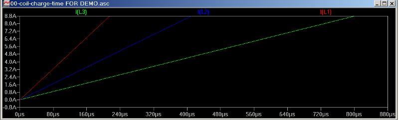

4. Coil Inductance
Probably the most limiting factor in the ultimate speed of a stepper motor system is the inductance designed into the stepper motor. If you wind a 2 milliHenry coil using 18 guage wire you’ll need about 3x times more turns if you use an air core than if you use an iron core. In a stepper motor the structure of the motor requires an iron core to get 200 steps per revolution. with air core coils you might get 20 steps per revolution.
Because of the structure of the stepper motor, the lowest inductance I have seen quoted for a stepper motor is around 1 mH (milliHenry) per coil, while many rate 12 mH or higher. In the graphs below you will see plots of charge time for a 2mH (red), a 4mH (blue), and an 8mH (green) coil charged from a 90Volt supply.
![images/inductance-vs-time.png](images/inductance-vs-time.png)
By 80 uS (microseconds) the 2 mH coil has achieved 3.2 Amps. At that same time, the 8 mH coil has only achieved about 0.9 Amps. If the stepper motor is rated at a certain torque at 3 Amps, but it only gets to 0.9 Amps it would seem like you have a little less than 1/3 of the rated torque at 80 uS per step, but it’s even less than that, since it only starts exerting that 1/3 torque at the 80 uS mark. At 40 uS it may only be delivering 1/6 of the full rated torque.
