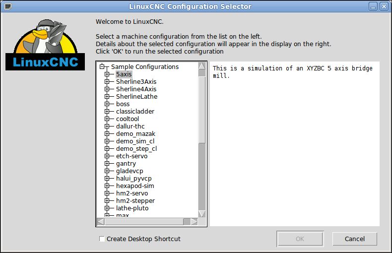

2. Configuration Launcher
When starting LinuxCNC from the CNC menu or from the command line without specifiying an ini file the Configuration Selector dialog starts.
The Configuration Selector dialog allows the user to pick one of their existing configurations (My Configurations) or select a new one (from the Sample Configurations) to be copied to their home directory. Copied configurations will appear under My Configurations on the next invocation of the Configuration Selector.
The Configuration Selector offers a selection of configurations organized:
My Configurations - User configurations located in ~/linuxcnc/configs
Sample Configurations - Sample configurations, when selected are copied to ~/linuxcnc/configs. Once you copy a sample configuration if you use the launcher pick it from My Configurations

Click any of the listed configurations to display specific information about it. Double-click a configuration or click OK to start the configuration. Select Create Desktop Shortcut and then click OK to add an icon on the Ubuntu desktop to directly launch this configuration without showing the Configuration Selector screen.
When you select a configuration from the Sample Configurations section, it will automaticly place a copy of that config in the linuxcnc/configs directory.
