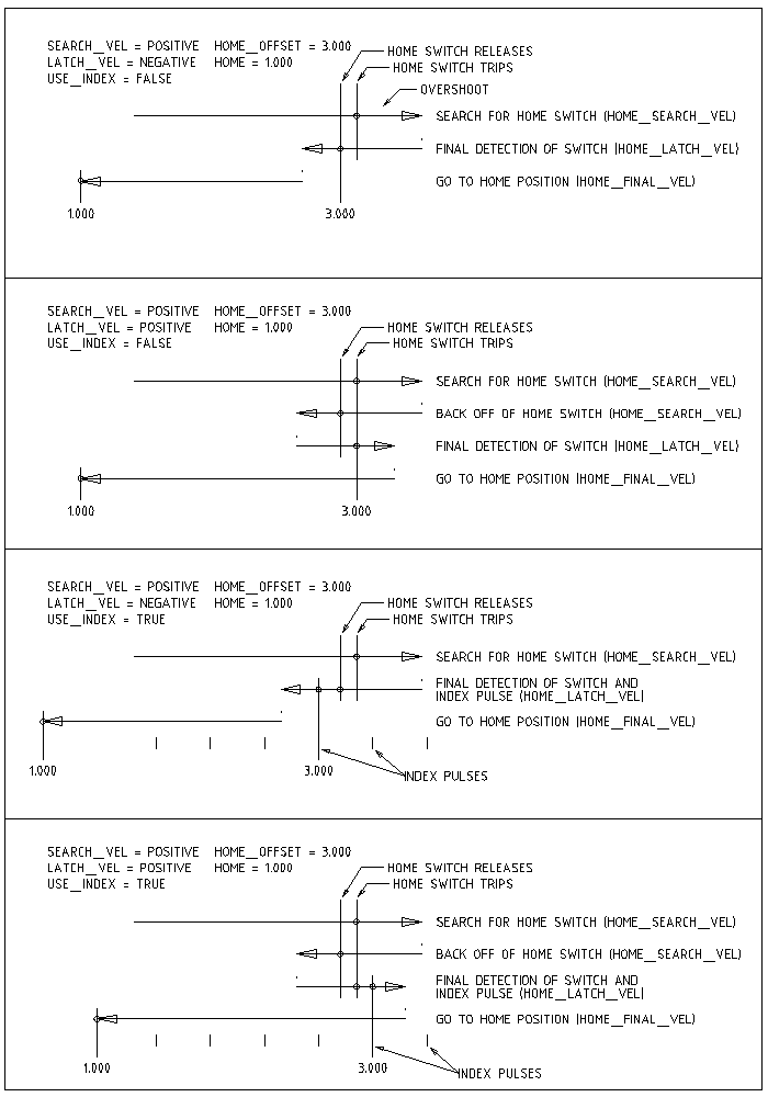

Homing seems simple enough - just move each joint to a known location, and set LinuxCNC’s internal variables accordingly. However, different machines have different requirements, and homing is actually quite complicated.
2. Homing Sequence
There are four possible homing sequences defined by the sign of HOME_SEARCH_VEL and HOME_LATCH_VEL, along with the associated configuration parameters as shown in the following table. Two basic conditions exist, HOME_SEARCH_VEL and HOME_LATCH_VEL are the same sign or they are opposite signs. For a more detailed description of what each configuration parameter does, see the following section.
![images/emc2-motion-homing-diag.png](images/emc2-motion-homing-diag.png)
