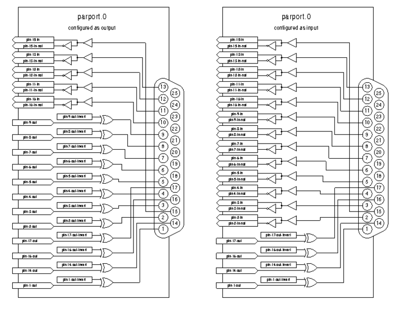

No other combinations are supported, and a port cannot be changed from input to output once the driver is installed. The Parport Block Diagram shows two block diagrams, one showing the driver when the data group is configured for output, and one showing it configured for input. For x mode, refer to the pin listing of halcmd show pin for pin direction assignment.

For each physical output pin, the driver creates a single HAL pin, for example: parport.0.pin-14-out.
Pins 2 through 9 are part of the data group and are output pins if the port is defined as an output port. (Output is the default.) Pins 1, 14, 16, and 17 are outputs in all modes. These HAL pins control the state of the corresponding physical pins.
For each physical input pin, the driver creates two HAL pins, for example: parport.0.pin-12-in and parport.0.pin-12-in-not.
Pins 10, 11, 12, 13, and 15 are always input pins. Pins 2 through 9 are input pins only if the port is defined as an input port. The -in HAL pin is TRUE if the physical pin is high, and FALSE if the physical pin is low. The -in-not HAL pin is inverted — it is FALSE if the physical pin is high. By connecting a signal to one or the other, the user can determine the state of the input. In x mode, pins 1, 14, 16, and 17 are also input pins.
