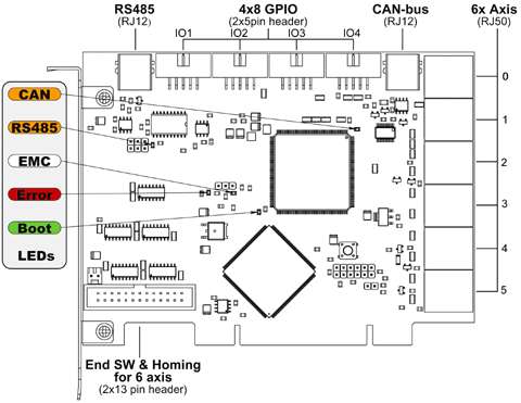

The following connectors can be found on the GM6-PCI card:
images/GM_PCIpinout.png
Figure 1. GM6-PCI card connectors and LEDs

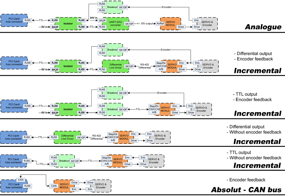

2.1. Axis interface modules
Small sized DIN rail mounted interface modules gives easy way of connecting different types of servo modules to the axis connectors. Seven different system configurations are presented in the System integration manual for evaluating typical applications. Also the detailed description of the Axis modules can be found in the System integration manual.
For evaluating the appropriate servo-drive structure the modules have to be connected as the following block diagram shows:
images/GM_AxisInterface.png
Figure 4. Servo axis interfaces

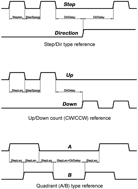

.steplen
(u32, R/W)
Length of step pulse in nano-seconds.
.stepspace
(u32, R/W)
Minimum time between two step pulses in nano-seconds.
.dirdelay
(u32, R/W)
Minimum time between step pulse and direction change in nano-seconds.
For evaluating the appropriate values see the timing diagrams below:
images/GM_RefSignals.png
Figure 5. Reference signal timing diagrams

5. End-, homing- and E-stop switches
images/GM_ENDSWpinout.png
Figure 6. Pin numbering of homing & end switch connector
Table 16. End- and homing switch connector pinout
25 23 21 19 17 15 13 11 9 7 5 3 1
GND
1/End-
2/End+
2/Hom-ing
3/End-
4/End+
4/Hom-ing
5/End-
6/End+
6/Hom-ing
E-Stop 2
V+ (Ext.)
26 24 22 20 18 16 14 12 10 8 6 4 2
GND
1/End+
1/Hom-ing
2/End-
3/End+
3/Hom-ing
4/End-
5/End+
5/Hom-ing
6/End-
E-Stop 1
V+ (Ext.)
The GM6-PCI motion control card has two limit- and one homing switch input for each axis. All the names of these pins begin as follows:

6. Status LEDs
6.1. CAN
Color: Orange
  • Blink, during data communication.
  • On, when any of the buffers are full - communication error.
  • Off, when no data communication.
6.2. RS485
Color: Orange
  • Blink, during initialization of modules on the bus
  • On, when the data communication is up between all initialized modules.
  • Off, when any of the initialized modules dropped off because of an error.
6.3. EMC
Color: White
  • Blink, when LinuxCNC is running.
  • Otherwise off.
6.4. Boot
Color: Green
  • On, when system booted successfully.
  • Otherwise off.
6.5. Error
Color: Red
  • Off, when there is no fault in the system.
  • Blink, when PCI communication error.
  • On, when watchdog timer overflowed.

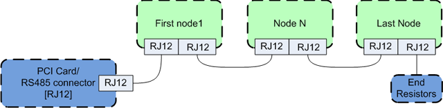

Automatic node recognizing:
Each node connected to the bus was recognized by the GM6-PCI card automatically. During starting LinuxCNC, the driver export pins and parameters of all available modules automatically.
Fault handling:
If a module does not answer regularly the GM6-PCI card drops down the module. If a module with output do not gets data with correct CRC regularly, the module switch to error sate (green LED blinking), and turns all outputs to error sate.
Connecting the nodes:
The modules on the bus have to be connected in serial topology, with termination resistors on the end. The start of the topology is the PCI card, and the end is the last module.
images/GM_RS485topology.png
Figure 7. Connecting the RS485 nodes to the GM6-PCI card
Adressing:
Each node on the bus has a 4 bit unique address that can be set with a red DIP switch.
