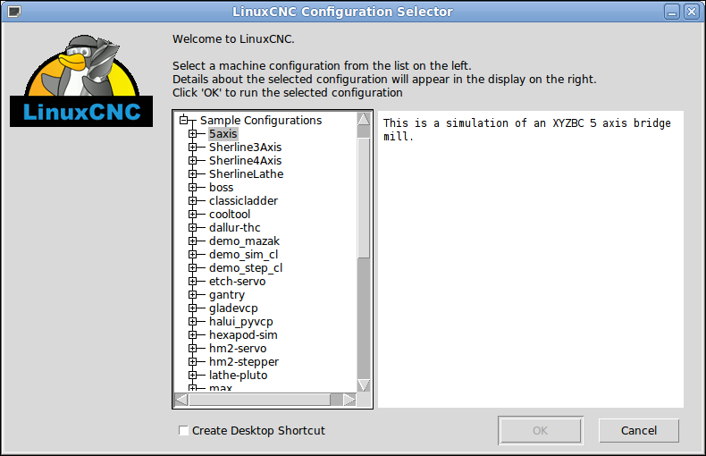

2. Configuration Selector
By default, the Configuration Selector dialog is shown when you first run LinuxCNC. Your own personalized configurations are shown at the top of the list, followed by sample configurations. Because each sample configuration is for a different type of hardware interface, almost all will not run without the hardware installed. The configurations listed under the category sim run entirely without attached hardware.
images/configuration-selector.png
Figure 1. LinuxCNC Configuration Selector
Click any of the listed configurations to display specific information about it. Double-click a configuration or click OK to start the configuration. Select Create Desktop Shortcut and then click OK to add an icon on the Ubuntu desktop to directly launch this configuration without showing the Configuration Selector screen.
When you select a configuration from the Sample Configurations section, it will automaticly place a copy of that config in the emc/configs directory.
