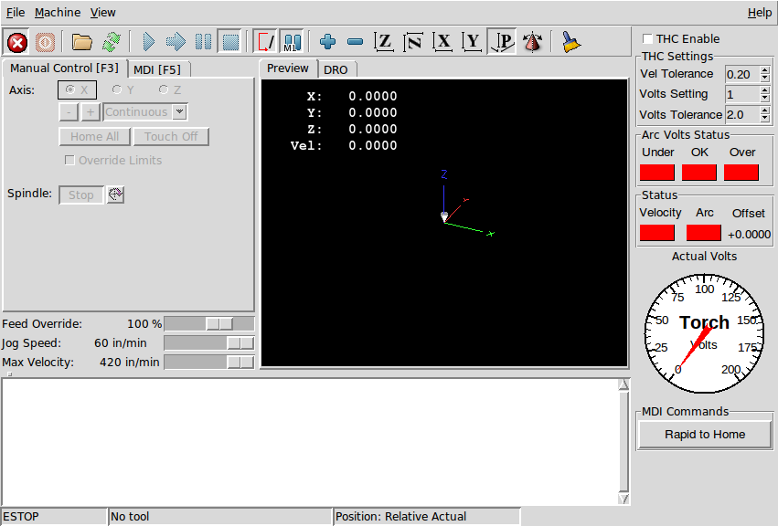

  • Axis, the standard GUI interface.

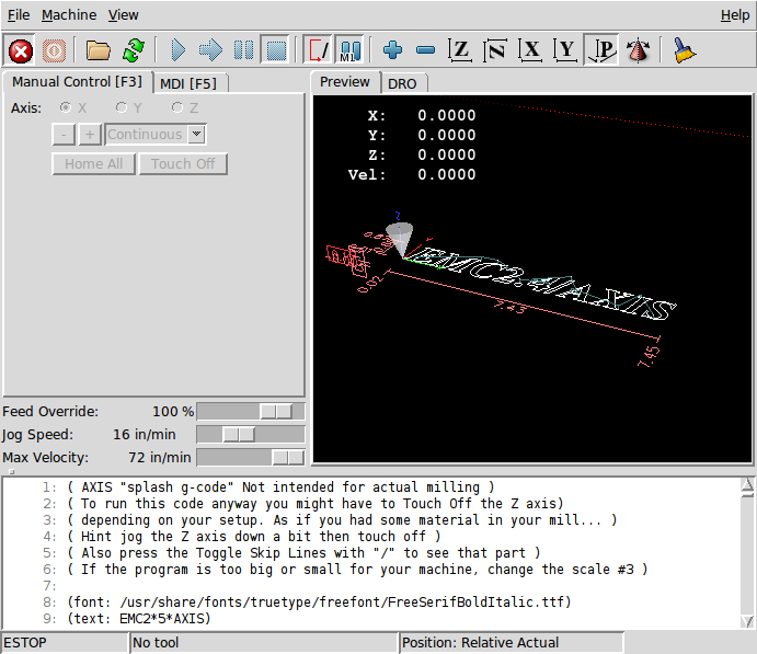

images/axis-2.5.png
Figure 2. Axis GUI

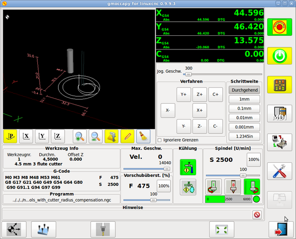

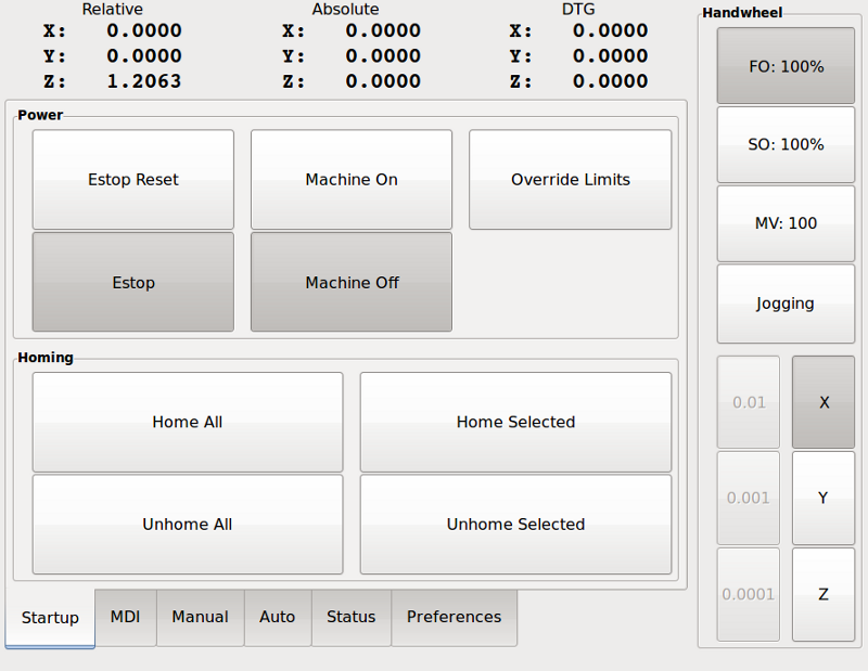

images/gmoccapy_4_axis.png
Figure 3. Gmoccapy

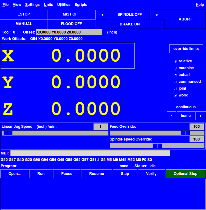

images/touchy.png
Figure 4. Touchy GUI

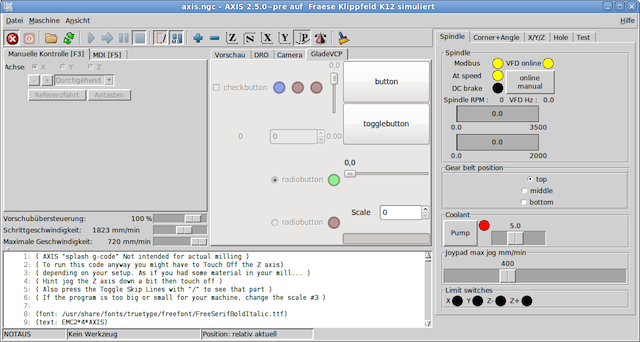

  • GladeVCP - a glade based virtual control panel that can be added to the Axis GUI or be stand alone.
images/axis-gladevcp.png
Figure 10. GladeVCP with Axis
