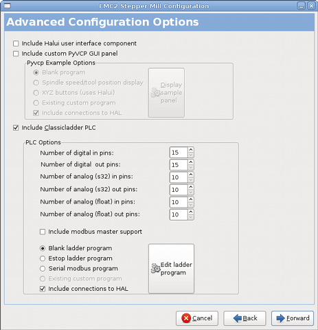

Objects of most interest are numPhysInputs, numPhysOutputs, numS32in, and numS32out.
Changing these numbers will change the number of HAL bit pins available. numPhysInputs and numPhysOutputs control how many HAL bit (on/off) pins are available. numS32in and numS32out control how many HAL signed integers (+- integer range) pins are available.
For example (you don’t need all of these to change just a few):
loadrt classicladder_rt numRungs=12 numBits=100 numWords=10
numTimers=10 numMonostables=10 numCounters=10 numPhysInputs=10
numPhysOutputs=10 numArithmExpr=100 numSections=4 numSymbols=200
numS32in=5 numS32out=5

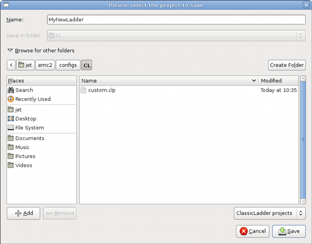

To load a ladder file:
loadusr classicladder myladder.clp

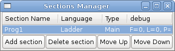

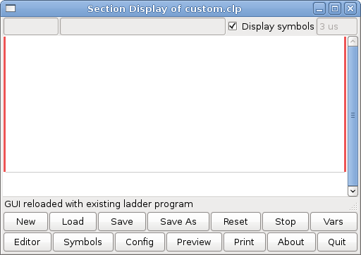

5.1. Sections Manager
When you first start up Classic Ladder you get an empty Sections Manager window.
images/Default_Sections_Manager.png
Figure 1. Sections Manager Default Window
This window allows you to name, create or delete sections and choose what language that section uses. This is also how you name a subroutine for call coils.

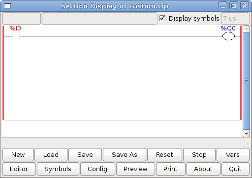

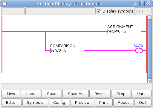

5.2. Section Display

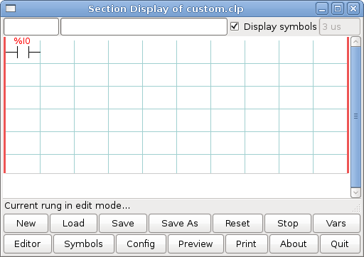

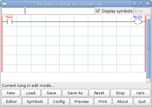

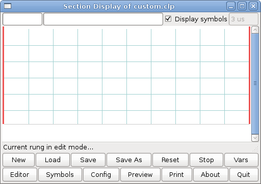

When you first start up Classic Ladder you get an empty Section Display window. Displayed is one empty rung.
images/Default_Section_Display.png
Figure 2. Section Display Default Window
Most of the buttons are self explanatory:
The Vars button is for looking at variables, toggle it to display one, the other, both, then none of the windows.
The Config button is used for modbus and shows the max number of ladder elements that was loaded with the real time module.
The Symbols button will display an editable list of symbols for the variables (hint you can name the inputs, outputs, coils etc).
The Quit button will shut down the user program meaning Modbus and the display. The real time ladder program will still run in the background.
The check box at the top right allows you to select whether variable names or symbol names are displayed

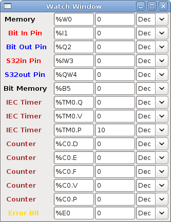

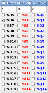

5.3. The Variable Windows
This are two variable windows: the Bit Status Window (boolean) and the Watch Window (signed integer). The Vars button is in the Section Display Window, toggle the Vars button to display one, the other, both, then none of the variable windows.
images/Bit_Status.png
Figure 3. Bit Status Window
The Bit Status Window displays some of the boolean (on/off) variable data. Notice all variables start with the % sign. The %I variables represent HAL input bit pins. The %Q represents the relay coil and HAL output bit pins. The %B represents an internal relay coil or internal contact. The three edit areas at the top allow you to select what 15 variables will be displayed in each column. For instance, if the %B Variable column were 15 entries high, and you entered 5 at the top of the column, variables %B5 to %B19 would be displayed. The check boxes allow you to set and unset %B variables manually as long as the ladder program isn’t setting them as outputs. Any Bits that are set as outputs by the program when Classic Ladder is running can not be changed and will be displayed as checked if on and unchecked if off.
images/watch_window.png
Figure 4. Watch Window
The Watch Window displays variable status. The edit box beside it is the number stored in the variable and the drop-down box beside that allow you to choose whether the number to be displayed in hex, decimal or binary. If there are symbol names defined in the symbols window for the word variables showing and the display symbols checkbox is checked in the section display window, symbol names will be displayed. To change the variable displayed, type the variable number, e.g. %W2 (if the display symbols check box is not checked) or type the symbol name (if the display symbols checkbox is checked) over an existing variable number/name and press the Enter Key.

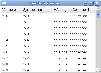

5.4. Symbol Window
images/Default_Symbols_names.png
Figure 5. Symbol Names window
This is a list of symbol names to use instead of variable names to be displayed in the section window when the display symbols check box is checked. You add the variable name (remember the % symbol and capital letters), symbol name . If the variable can have a HAL signal connected to it (%I, %Q, and %W-if you have loaded s32 pin with the real time module) then the comment section will show the current HAL signal name or lack thereof. Symbol names should be kept short to display better. Keep in mind that you can display the longer HAL signal names of %I, %Q and %W variable by clicking on them in the section window. Between the two, one should be able to keep track of what the ladder program is connected to!

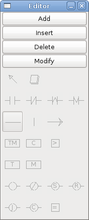

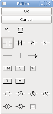

5.5. The Editor window
images/Editor.png
Figure 6. Editor Window
  • Add - adds a rung after the selected rung
  • Insert - inserts a rung before the selected rung
  • Delete - deletes the selected rung
  • Modify - opens the selected rung for editing
Starting from the top left image:
  • Object Selector, Eraser
  • N.O. Input, N.C. Input, Rising Edge Input , Falling Edge Input
  • Horizontal Connection, Vertical Connection , Long Horizontal Connection
  • Timer IEC Block, Counter Block, Compare Variable
  • Old Timer Block, Old Monostable Block (These have been replaced by the IEC Timer)
  • COILS - N.O. Output, N.C. Output, Set Output, Reset Output
  • Jump Coil, Call Coil, Variable Assignment
A short description of each of the buttons:
  • Selector - allows you to select existing objects and modify the information.
  • Eraser - erases an object.
  • N.O. Contact - creates a normally open contact. It can be an external HAL-pin (%I) input contact, an internal-bit coil (%B) contact or a external coil (%Q) contact. The HAL-pin input contact is closed when the HAL-pin is true. The coil contacts are closed when the corresponding coil is active (%Q2 contact closes when %Q2 coil is active).
  • N.C. Contact - creates a normally closed contact. It is the same as the N.O. contact except that the contact is open when the HAL-pin is true or the coil is active.
  • 'Rising Edge Contact - creates a contact that is closed when the HAL-pin goes from False to true, or the coil from not-active to active.
  • Falling Edge Contact - creates a contact that is closed when the HAL-pin goes from true to false or the coil from active to not.
  • Horizontal Connection - creates a horizontal connection to objects.
  • Vertical Connection - creates a vertical connection to horizontal lines.
  • Horizontal Running Connection - creates a horizontal connection between two objects and is a quick way to connect objects that are more than one block apart.
  • IEC Timer - creates a timer and replaces the Timer.
  • Timer - creates a Timer Module (depreciated use IEC Timer instead).
  • Monostable - creates a one-shot monostable module
  • Counter - creates a counter module.
  • Compare - creates a compare block to compare variable to values or other variables. (eg %W1<=5 or %W1=%W2) Compare cannot be placed in the right most side of the section display.
  • Variable Assignment - creates an assignment block so you to assign values to variables. (eg %W2=7 or %W1=%W2) ASSIGNMENT functions can only be placed at the right most side of the section display.

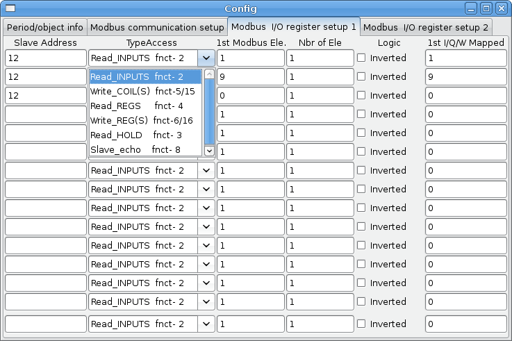

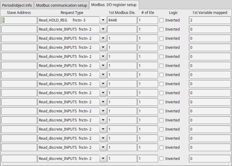

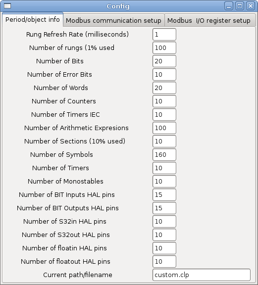

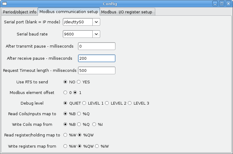

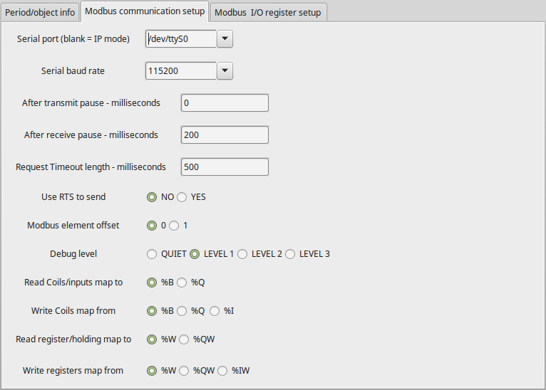

5.6. Config Window
The config window shows the current project status and has the Modbus setup tabs.
images/Config.png
Figure 7. Config Window

6.7. VARIABLE ASSIGNMENT
For variable assignment, e.g. assign this number (or evaluated number) to this variable %xxx, there are two math functions MINI and MAXI that check a variable for maximum (0x80000000) and minimum values (0x07FFFFFFF) (think signed values) and keeps them from going beyond.
When a new variable assignment block is opened be sure to delete the # symbol when you enter an assignment.
To assign a value of 10 to the timer preset of IEC Timer 0 the syntax would be:
%TM0.P=10
To assign the value of 12 to s32out bit 3 the syntax would be:
%QW3=12
Note
When you assign a value to a variable with the variable assignment block the value is retained until you assign a new value using the variable assignment block. The last value assigned will be restored when LinuxCNC is started.
The following figure shows an Assignment and a Comparison Example. %QW0 is a S32out bit and %IW0 is a S32in bit. In this case the HAL pin classicladder.0.s32out-00 will be set to a value of 5 and when the HAL pin classicladder.0.s32in-00 is 0 the HAL pin classicladder.0.out-00 will be set to True.
images/AssignCompare-Ladder.png
Figure 8. Assign/Compare Example
images/Assignment_Expression.png
images/Comparison_Expression.png

7. Classic Ladder Variables
These Variables are used in COMPARE or OPERATE to get information about, or change specs of, ladder objects such as changing a counter preset, or seeing if a timer is done running.
List of variables :
  • %Bxxx - Bit memory xxx (Boolean)
  • %Wxxx - Word memory xxx (32 bits signed integer)
  • %IWxxx - Word memory xxx (S32 in pin)
  • %QWxxx - Word memory xxx (S32 out pin)
  • %IFxx - Word memory xx (Float in pin) (converted to S32 in Classic Ladder)
  • %QFxx - Word memory xx (Float out pin) (converted to S32 in Classic Ladder)
  • %Txx.R - Timer xx running (Boolean, user read only)
  • %Txx.D - Timer xx done (Boolean, user read only)
  • %Txx.V - Timer xx current value (integer, user read only)
  • %Txx.P - Timer xx preset (integer)
  • %TMxxx.Q - Timer xxx done (Boolean, read write)
  • %TMxxx.P - Timer xxx preset (integer, read write)
  • %TMxxx.V - Timer xxx value (integer, read write)
  • %Mxx.R - Monostable xx running (Boolean)
  • %Mxx.V - Monostable xx current value (integer, user read only)
  • %Mxx.P - Monostable xx preset (integer)
  • %Cxx.D - Counter xx done (Boolean, user read only)
  • %Cxx.E - Counter xx empty overflow (Boolean, user read only)
  • %Cxx.F - Counter xx full overflow (Boolean, user read only)
  • %Cxx.V - Counter xx current value (integer)
  • %Cxx.P - Counter xx preset (integer)
  • %Ixxx - Physical input xxx (Boolean) (HAL input bit)
  • %Qxxx - Physical output xxx (Boolean) (HAL output bit)
  • %Xxxx - Activity of step xxx (sequential language)
  • %Xxxx.V - Time of activity in seconds of step xxx (sequential language)
  • %Exx - Errors (Boolean, read write(will be overwritten))
  • Indexed or vectored variables - These are variables indexed by another variable. Some might call this vectored variables. Example: %W0[%W4] => if %W4 equals 23 it corresponds to %W23

images/Config-io.png
Figure 9. Config I/O
images/Config-com.png
Figure 10. Config Coms
  • SERIAL PORT - For IP blank. For serial the location/name of serial driver eg. /dev/ttyS0 ( or /dev/ttyUSB0 for a USB-to-serial converter).
  • SERIAL SPEED - Should be set to speed the slave is set for - 300, 600, 1200, 2400, 4800, 9600, 19200, 38400, 57600, 115200 are supported.
  • PAUSE AFTER TRANSMIT - Pause (milliseconds) after transmit and before receiving answer, some devices need more time (e.g., USB-to-serial converters).
  • PAUSE INTER-FRAME - Pause (milliseconds) after receiving answer from slave. This sets the duty cycle of requests (it’s a pause for EACH request).
  • REQUEST TIMEOUT LENGTH - Length (milliseconds) of time before we decide that the slave didn’t answer.
  • MODBUS ELEMENT OFFSET - used to offset the element numbers by 1 (for manufacturers numbering differences).
  • DEBUG LEVEL - Set this to 0-3 (0 to stop printing debug info besides no-response errors).
  • READ COILS/INPUTS MAP TO - Select what variables that read coils/inputs will update. (B or Q).
  • WRITE COILS MAP TO - Select what variables that write coils will updated.from (B,Q,or I).
  • READ REGISTERS/HOLDING - Select what variables that read registers will update. (W or QW).
  • WRITE REGISTERS MAP TO - Select what variables that read registers will updated from. (W, QW, or IW).
  • SLAVE ADDRESS - For serial the slaves ID number usually settable on the slave device (usually 1-256) For IP the slave IP address plus optionally the port number.
  • TYPE ACCESS - This selects the MODBUS function code to send to the slave (eg what type of request).
  • COILS / INPUTS - Inputs and Coils (bits) are read from/written to I, B, or Q variables (user selects).
  • REGISTERS (WORDS) - Registers (Words/Numbers) map to IW, W, or QW variables (user selects).
  • 1st MODBUS ELEMENT - The address (or register number) of the first element in a group. (remember to set MODBUS ELEMENT OFFSET properly).
  • NUMBER OF ELEMENTS - The number of elements in this group.
  • LOGIC - You can invert the logic here.
  • 1st%I%Q IQ WQ MAPPED - This is the starting number of %B, %I, %Q, %W, %IW, or %QW variables that are mapped onto/from the modbus element group (starting at the first modbus element number).
In the example above: Port number - for my computer /dev/ttyS0 was my serial port.
The serial speed is set to 9600 baud.
Slave address is set to 12 (on my VFD I can set this from 1-31, meaning I can talk to 31 VFDs maximum on one system).
The first line is set up for 8 input bits starting at the first register number (register 1). So register numbers 1-8 are mapped onto Classic Ladder’s %B variables starting at %B1 and ending at %B8.
The second line is set for 2 output bits starting at the ninth register number (register 9) so register numbers 9-10 are mapped onto Classic Ladder’s %Q variables starting at %Q9 ending at %Q10.
The third line is set to write 2 registers (16 bits each) starting at the 0th register number (register 0) so register numbers 0-1 are mapped onto Classic Ladder’s %W variables starting at %W0 ending at %W1.
It’s easy to make an off-by-one error as sometimes the modbus elements are referenced starting at one rather then 0 (actually by the standard that is the way it’s supposed to be!) You can use the modbus element offset radio button to help with this.
The documents for your modbus slave device will tell you how the registers are set up- there is no standard way.
The SERIAL PORT, PORT SPEED, PAUSE, and DEBUG level are editable for changes (when you close the config window values are applied, though Radio buttons apply immediately).
To use the echo function select the echo function and add the slave number you wish to test. You don’t need to specify any variables.
The number 257 will be sent to the slave number you specified and the slave should send it back. you will need to have Classic Ladder running in a terminal to see the message.

10. Setting up Classic Ladder
In this section we will cover the steps needed to add Classic Ladder to a Stepconf Wizard generated config. On the advanced Configuration Options page of Stepconf Wizard check off "Include Classic Ladder PLC".
images/stepconf_ladder.png
Figure 11. Stepconf Classic Ladder
10.1. Add the Modules
If you used the Stepconf Wizard to add Classic Ladder you can skip this step.
To manually add Classic Ladder you must first add the modules. This is done by adding a couple of lines to the custom.hal file.

Now start up your config and select "File/Ladder Editor" to open up the Classic Ladder GUI. You should see a blank Section Display and Sections Manager window as shown above. In the Section Display window open the Editor. In the Editor window select Modify. Now a Properties window pops up and the Section Display shows a grid. The grid is one rung of ladder. The rung can contain branches. A simple rung has one input, a connector line and one output. A rung can have up to six horizontal branches. While it is possible to have more than one circuit in a run the results are not predictable.

Now click on the N.O. Input in the Editor Window.
images/Editor_NO_Input.png
Figure 13. Editor Window
Now click in the upper left grid to place the N.O. Input into the ladder.
images/Section_Display_Build01.png
Figure 14. Section Display with Input
Repeat the above steps to add a N.O. Output to the upper right grid and use the Horizontal Connection to connect the two. It should look like the following. If not, use the Eraser to remove unwanted sections.
images/Section_Display_Build02.png
Figure 15. Section Display with Rung
Now click on the OK button in the Editor window. Now your Section Display should look like this.
images/Section_Display_Build03.png
Figure 16. Section Display Finished
To save the new file select Save As and give it a name. The .clp extension will be added automatically. It should default to the running config directory as the place to save it.
images/SaveAs.png
Figure 17. Save As Dialog
Again if you used the Stepconf Wizard to add Classic Ladder you can skip this step.
