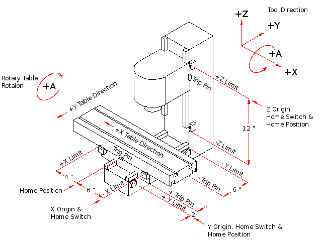

6. Machine Configurations
The following diagram shows a typical mill showing direction of travel of the tool and the mill table and limit switches. Notice how the mill table moves in the opposite direction of the Cartesian coordinate system arrows shown by the Tool Direction image. This makes the tool move in the correct direction in relation to the material.
images/mill-diagram.png
Figure 2. Mill Configuration

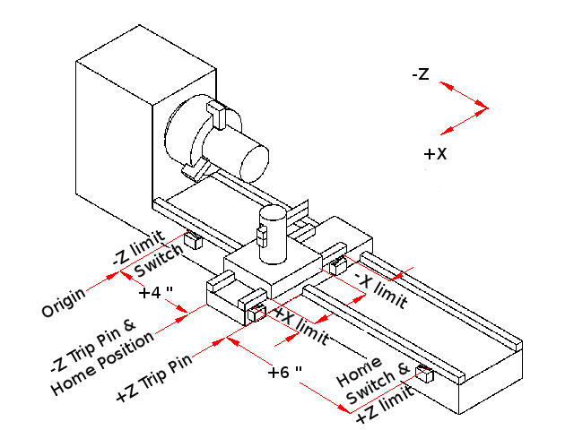

The following diagram shows a typical lathe showing direction of travel of the tool and limit switches.
images/lathe-diagram.png
Figure 3. Lathe Configuration
