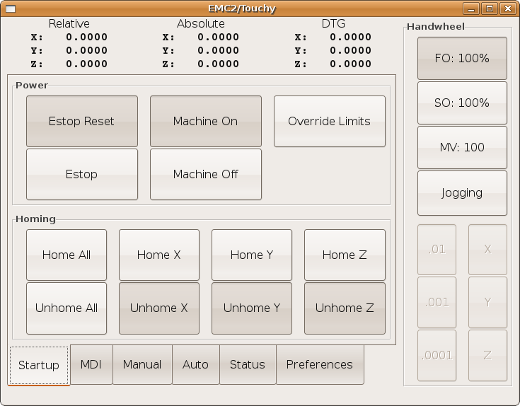

Touchy is a GUI for touch screens. It needs no mouse or keyboard.
Figure: Touchy
