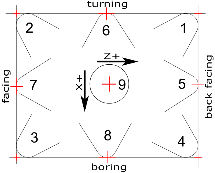

1.4.2 Lathe Format Tool Files
The “lathe format” of a tool file is shown in Table [.].
Pocket FMS ZOFFSET XOFFSET DIA FRONTANGLE BACKANGLE ORIENTATION Comment
1 1 0.0 0.0 0.1 95.0 155.0 1
2 2 0.5 0.5 0.1 120 60 6
Table: Sample Tool File (lathe format)
The Pocket, FMS, DIA and Comment fields are as for mill format tool files. The ZOFFSET field is the same as the TLO field of mill format tool files. The DIA is also used by the AXIS gui display.
The XOFFSET field gives an offset for the X coordinate when tool length offsets are in effect.
The ORIENTATION field gives the orientation of the lathe tool, as illustrated in [.]. The red cross is the controlled point. See [.].
The FRONTANGLE and BACKANGLE fields are used by some user interfaces to display a fancy representation of the lathe tool.
Figure: Tool Orientations
