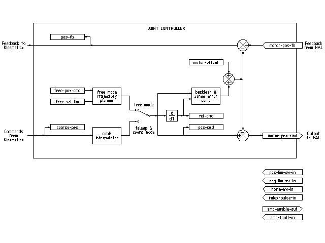

3.2 Block diagrams and Data Flow
Figure [.] is a block diagram of a joint controller. There is one joint controller per joint. The joint controllers work at a lower level than the kinematics, a level where all joints are completely independent. All the data for a joint is in a single joint structure. Some members of that structure are visible in the block diagram, such as coarse_pos, pos_cmd, and motor_pos_fb.
Figure: Joint Controller Block Diagram
Figure [.] shows five of the seven sets of position information that form the main data flow through the motion controller. The seven forms of position data are as follows:
  1. emcmotStatus->carte_pos_cmd - This is the desired position, in Cartesian coordinates. It is updated at the traj rate, not the servo rate. In coord mode, it is determined by the traj planner. In teleop mode, it is determined by the traj planner? In free mode, it is either copied from actualPos, or generated by applying forward kins to (2) or (3).
  2. emcmotStatus->joints[n].coarse_pos - This is the desired position, in joint coordinates, but before interpolation. It is updated at the traj rate, not the servo rate. In coord mode, it is generated by applying inverse kins to (1) In teleop mode, it is generated by applying inverse kins to (1) In free mode, it is copied from (3), I think.
  3. emcmotStatus->joints[n].pos_cmd - This is the desired position, in joint coords, after interpolation. A new set of these coords is generated every servo period. In coord mode, it is generated from (2) by the interpolator. In teleop mode, it is generated from (2) by the interpolator. In free mode, it is generated by the free mode traj planner.
  4. emcmotStatus->joints[n].motor_pos_cmd - This is the desired position, in motor coords. Motor coords are generated by adding backlash compensation, lead screw error compensation, and offset (for homing) to (3). It is generated the same way regardless of the mode, and is the output to the PID loop or other position loop.
  5. emcmotStatus->joints[n].motor_pos_fb - This is the actual position, in motor coords. It is the input from encoders or other feedback device (or from virtual encoders on open loop machines). It is "generated" by reading the feedback device.
  6. emcmotStatus->joints[n].pos_fb - This is the actual position, in joint coordinates. It is generated by subtracting offset, lead screw error compensation, and backlash compensation from (5). It is generated the same way regardless of the operating mode.
  7. emcmotStatus->carte_pos_fb - This is the actual position, in Cartesian coordinates. It is updated at the traj rate, not the servo rate. Ideally, actualPos would always be calculated by applying forward kinematics to (6). However, forward kinematics may not be available, or they may be unusable because one or more axes aren't homed. In that case, the options are: A) fake it by copying (1), or B) admit that we don't really know the Cartesian coordinates, and simply don't update actualPos. Whatever approach is used, I can see no reason not to do it the same way regardless of the operating mode. I would propose the following: If there are forward kins, use them, unless they don't work because of unhomed axes or other problems, in which case do (B). If no forward kins, do (A), since otherwise actualPos would _never_ get updated.

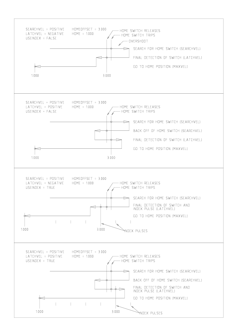

3.4 Homing
3.4.1 Overview
Homing seems simple enough - just move each joint to a known location, and set EMC's internal variables accordingly. However, different machines have different requirements, and homing is actually quite complicated.
In EMC2, homing is done in free mode. The core of the homing algorithm is a state machine contained in the function “do_homing()”, which in turn makes use of the free mode trajectory planner. Homing does not use kinematics or the coordinated trajectory planner.
3.4.2 Homing Sequence
Figure [.] shows four possible homing sequences, along with the associated configuration parameters. For a more detailed description of what each configuration parameter does, see the following section.
Figure: Homing Sequences
3.4.3 Configuration
There are six pieces of information that determine exactly how the home sequence behaves. They are stored in the joint structure, and each joint is configured independently.
3.4.3.1 home_search_vel
'home_search_vel' is a member of the joint structure (as defined in motion.h). The default value is zero. A value of zero causes EMC to assume that there is no home switch. The search and latch stages of homing are skipped, EMC declares the current position to be “home_offset”, and does a rapid to “home” if “home” is not equal to “home_offset”.
If 'home_search_vel' is non-zero, then EMC assumes that there is a home switch. It begins searching for the home switch by moving in the direction specified by the sign of 'home_search_vel', at a speed determined by its absolute value. When the home switch is detected, the joint will stop as fast as possible, but there will always be some overshoot. The amount of overshoot depends on the speed. If it is too high, the joint might overshoot enough to hit a limit switch or crash into the end of travel. On the other hand, if 'home_search_vel' is too low, homing can take a long time.
3.4.3.2 home_latch_vel
'home_latch_vel' is also a member of the joint structure. It specifies the speed and direction that EMC uses when it makes its final accurate determination of the home switch and index pulse location. It will usually be slower than the search velocity to maximize accuracy. If search_vel and latch_vel have the same sign, then the latch phase is done while moving in the same direction as the search phase. (In that case, EMC first backs off the switch, before moving towards it again at the latch velocity.) If search_vel and latch_vel have opposite signs, the latch phase is done while moving in the opposite direction from the search phase. That means EMC will latch the first pulse after it moves off the switch. If 'search_vel' is zero, the latch phase is skipped and this parameter is ignored. If 'search_vel' is non-zero and this parameter is zero, it is an error and the homing operation will fail. The default value is zero.
3.4.3.3 home_final_vel
'home_final_vel' is also a member of the joint structure. It specifies the speed that EMC uses when it makes its move from HOME_OFFSET to the HOME position. If the HOME_FINAL_VEL is missing from the ini file, then the maximum joint speed is used to make this move.
3.4.3.4 home_ignore_limits
'home_ignore_limits' is a single bit within the joint structure member 'home_flags'. This flag determines whether EMC will ignore the limit switch inputs. Some machine configurations do not use a separate home switch, instead they route one of the limit switch signals to the home switch input as well. In this case, EMC needs to ignore that limit during homing. The default value for this parameter is OFF.
3.4.3.5 home_use_index
'home_use_index' is a single bit within the joint structure member 'home_flags'. It specifies whether or not there is an index pulse. If the flag is true, EMC will latch on the rising edge of the index pulse. If false, EMC will latch on either the rising or falling edge of the home switch (depending on the signs of search_vel and latch_vel). If 'search_vel' is zero, the latch phase is skipped and this parameter is ignored. The default value is OFF.
3.4.3.6 home_offset
'home_offset' is a member of the joint structure. It contains the location of the home switch or index pulse, in joint coordinates. It can also be treated as the distance between the point where the switch or index pulse is latched and the zero point of the joint. After detecting the index pulse, EMC sets the joint coordinate of that point to “home_offset”. The default value is zero.
3.4.3.7 home
'home' is a member of the joint structure. It is the position that the joint will go to upon completion of the homing sequence. After detecting the index pulse, and setting the coordinate of that point to “home_offset”, EMC makes a move to "home" as the final step of the homing process. The default value is zero. Note that even if this parameter is the same as “home_offset”, the axis will slightly overshoot the latched position as it stops. Therefore there will always be a small move at this time (unless search_vel is zero, and the entire search/latch stage was skipped). This final move will be made at the joint's maximum velocity. Since the axis is now homed, there should be no risk of crashing the machine, and a rapid move is the quickest way to finish the homing sequence. 2
3.5 Backlash and Screw Error Compensation

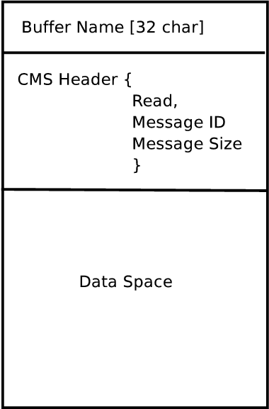

At the heart of libnml is the CMS class, it contains most of the functions used by libnml and ultimately NML. Many of the internal functions are overloaded to allow for specific hardware dependent methods of data passing. Ultimately, everything revolves around a central block of memory (referred to as the “message buffer” or just “buffer”). This buffer may exist as a shared memory block accessed by other CMS/NML processes, or a local and private buffer for data being transferred by network or serial interfaces.
The buffer is dynamically allocated at run time to allow for greater flexibility of the CMS/NML sub-system. The buffer size must be large enough to accommodate the largest message, a small amount for internal use and allow for the message to be encoded if this option is chosen (encoded data will be covered later). Figure [.] is an internal view of the buffer space.
Figure: CMS buffer
The CMS base class is primarily responsible for creating the communications pathways and interfacing to the O.S.
