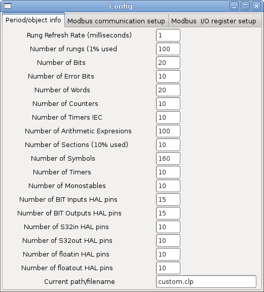

1.4.3 Variables

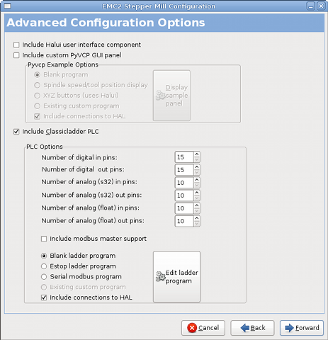

It is possible to configure the number of each type of ladder object while loading the ClassicLadder real time module. If you do not configure the number of ladder objects ClassicLadder will use the default values.
Object Name Variable Name Default Value
Number of rungs (numRungs) 100
Number of bits (numBits) 20
Number of word variables (numWords) 20
Number of timers (numTimers) 10
Number of timers IEC (numTimersIec) 10
Number of monostables (numMonostables) 10
Number of counters (numCounters) 10
Number of hal inputs bit pins (numPhysInputs) 15
Number of hal output bit pins (numPhysOutputs) 15
Number of arithmetic expressions (numArithmExpr) 50
Number of Sections (numSections) 10
Number of Symbols (numSymbols) Auto
Number of S32 inputs (numS32in) 10
Number of S32 outputs (numS32out) 10
Number of Float inputs (numFloatIn) 10
Number of Float outputs (numFloatOut) 10
Table: Default Variable Count
Objects of most interest are numPhysInputs, numPhysOutputs, numS32in, and numS32out.
Changing these numbers will change the number of HAL bit pins available. numPhysInputs and numPhysOutputs control how many HAL bit (on/off) pins are available. numS32in and numS32out control how many HAL signed integers (+- integer range) pins are available.
For example (you don't need all of these to change just a few):
loadrt classicladder_rt numRungs=12 numBits=100 numWords=10 numTimers=10 numMonostables=10 numCounters=10 numPhysInputs=10 numPhysOutputs=10 numArithmExpr=100 numSections=4 numSymbols=200 numS32in=5 numS32out=5
To load the default number of objects:

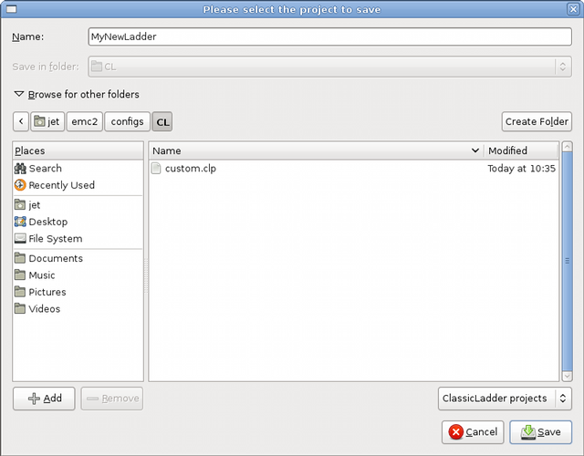

To load a ladder file:
loadusr classicladder myladder.clp

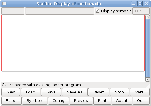

If you first load ladder program with the --nogui option then load ClassicLadder again with no options the GUI will display the last loaded ladder program.
In AXIS you can load the GUI from File/Ladder Editor...

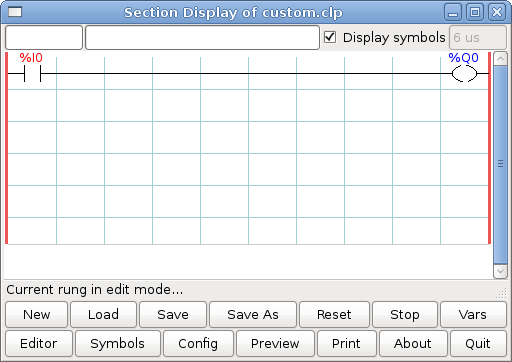

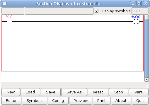

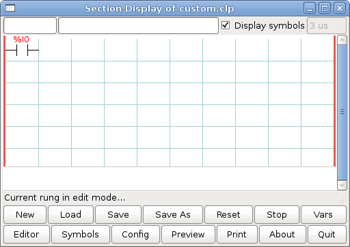

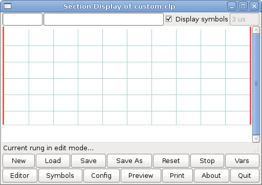

1.6.2 Section Display
When you first start up ClassicLadder you get an empty Section Display window.
Figure: Section Display Default Window
Most of the buttons are self explanatory:
The vars button is for looking at variables, toggle it to display one, the other, both, then none of the windows.
The config button is used for modbus and shows the max number of ladder elements that was loaded with the real time module.
The symbols button will display an editable list of symbols for the variables (hint you can name the inputs, outputs, coils etc).
The quit button will shut down the user program meaning Modbus and the display- the real time ladder program will still run in the back ground.
The check box at the top right allows you to select whether variable names or symbol names are displayed
You might notice that there is a line under the ladder program display that reads “Project failed to load...” That is the status bar that gives you info about elements of the ladder program that you click on in the display window. This status line will now display HAL signal names for variables %I, %Q and the first %W (in an equation) You might see some funny labels, such as (103) in the rungs. This is displayed (on purpose) because of an old bug- when erasing elements older versions sometimes didn't erase the object with the right code. You might have noticed that the long horizontal connection button sometimes didn't work in the older versions. This was because it looked for the 'free' code but found something else. The number in the brackets is the unrecognized code. The ladder program will still work properly, to fix it erase the codes with the editor and save the program.

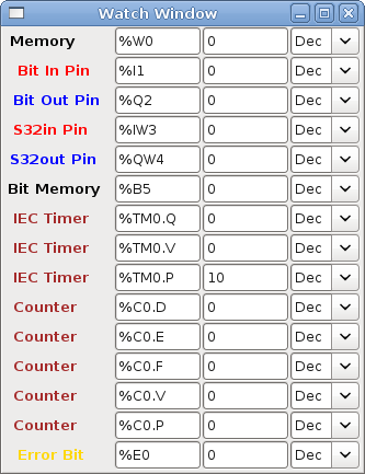

1.6.3 The Variable Windows
This are two variable windows: bool and signed integer. the vars button is in the section display window, toggle the Vars button to display one, the other, both, then none of the windows.
Figure: Bit Status Window
The Bool window displays some of all the bool (on/off) variable data . Notice all variable start with the % sign. The %I variable represents HAL input bit pins. The %Q represents the relay coil and HAL output bit pins. The %B represents an internal relay coil or internal contact The three edit areas at the top allow you to select what 15 variable will be displayed in each column. For instance if there were 30 %B variable and you entered 5 at the top of the column, variable %B5 to %B19 would be displayed. The check boxes allow you to set and unset %B variables manually as long as the ladder program isn't setting them as outputs. Any Bits that are set as outputs by the program when ClassicLadder is running can not be changed and will be displayed as checked if on and unchecked if off.
Figure: Watch Window
The Watch Window displays variable status. The edit box beside it is the number stored in the variable and the drop-down box beside that allow you to choose whether the number to be displayed in hex, decimal or binary. If there are symbol names defined in the symbols window for the word variables showing and the 'display symbols' checkbox is checked the the section display window, symbol names will be displayed. To change the variable displayed type the variable number eg. %W2 (if display symbols check box is not checked) or symbol name (if the display symbols checkbox is checked) over an existing variable number/name and press the Enter Key.

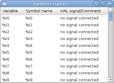

1.6.4 Symbol Window
Figure: Symbol Names window
This is a list of 'symbol' names to use instead of variable names to be displayed in the section window when the 'display symbols' check box is checked. You add the variable name (remember the '%' symbol and capital letters), symbol name . If the variable can have a HAL signal connected to it (%I, %Q, and %W-if you have loaded s32 pin with the real time module) then the comment section will show the current HAL signal name or lack there of. symbol names should be kept short to display better. keep in mind that you can display the longer HAL signal name of %I, %Q and %W variable by clicking on them in the section window. Between the two on should be able to keep track of what the ladder program is connected to!

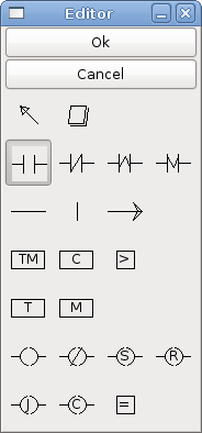

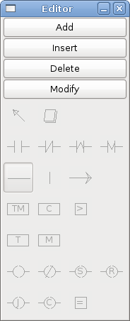

1.6.5 The Editor window
Figure: Editor Window
Starting from the top left image:
  1. Object Selector, Eraser
  2. N.O. Input, N.C. Input, Rising Edge Input , Falling Edge Input
  3. Horizontal Connection, Vertical Connection , Long Horizontal Connection
  4. Timer IEC Block, Counter Block, Compare Variable
  5. Old Timer Block, Old Monostable Block (These have been replaced by the IEC Timer)
  6. COILS - N.O. Output, N.C. Output, Set Output, Reset Output
  7. Jump Coil, Call Coil, Variable Assignment
A short description of each of the buttons:
1.6.6 Config Window
The config window shows the current project status and has the Modbus setup tabs.

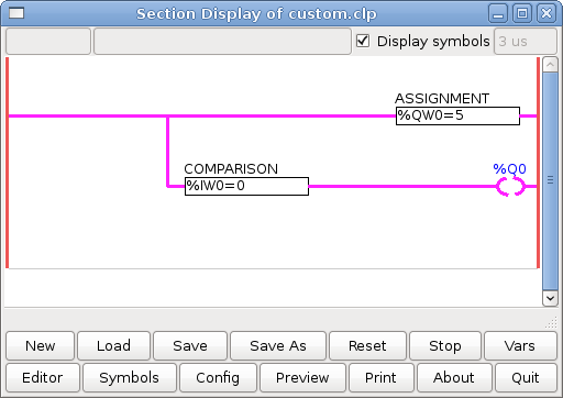

1.7.7 VARIABLE ASSIGNMENT
For variable assignment. eg assign this number (or evaluated number) to this variable %xxx there are two math functions MINI and MAXI that check a variable for maximum (0x80000000) and minimum values (0x07FFFFFFF) (think signed values) and keeps them from going beyond.
When a new variable assignment block is opened be sure and delete the # symbol when you enter an assignment.
To assign a value of 10 to the timer preset of IEC Timer 0 the syntax would be:
%TM0.P=10
To assign the value of 12 to S32out bit 3 the syntax would be:
%QW3=12
The following figure shows an Assignment and a Comparison Example. %QW0 is a S32out bit and %IW0 is a S32in bit. In this case the HAL pin classicladder.0.s32out-00 will be set to a value of 5 and when the HAL pin classicladder.0.s32in-00 is 0 the HAL pin classicladder.0.out-00 will be set to True.
Figure: Assign/Compare Example

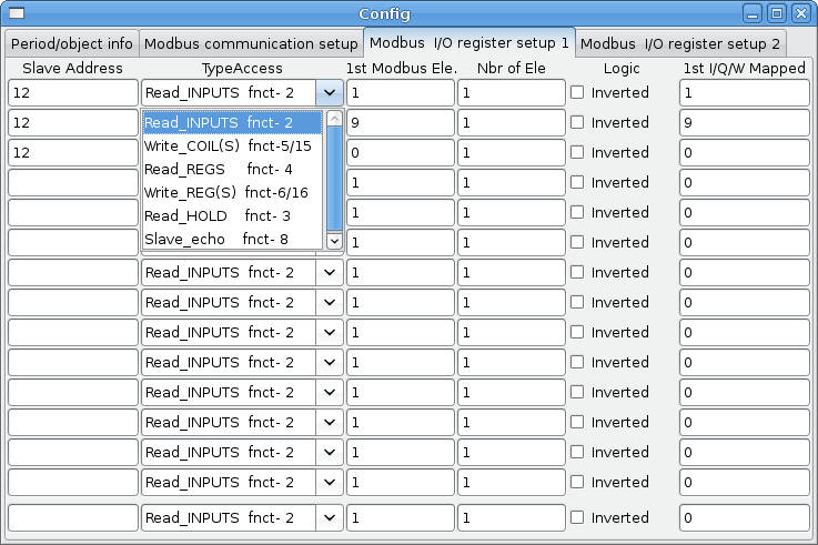

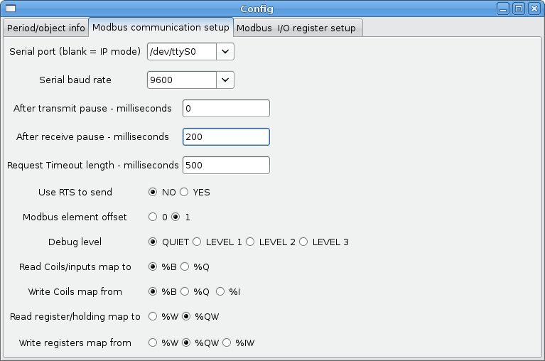

1.10 Modbus
Things to consider:
To get MODBUS to initialize you must specify that when loading the classicladder userspace program eg. loadusr -w classicladder --modmaster myprogram.clp (assuming myprogram.clp is present -w makes HAL wait till you close classicladder before closing realtime session) my idea behind this is to get a working modbus solution out there then we can decide how it should be done in the best way. As it stands now classicladder also loads a TCP modbus slave (if you add --modserver on command line) - I have not tested this nor have I tested the TCP modbus master. I have done some testing with the serial port and had to add some functions to get it to talk to my VFD -but it does work. Modbus function 1,2,3,4,5,6,8,15,16 (read coils,read inputs, read holding registers, read input registers, write single coils, write single register, echo test, write multiple coils, write multiply registers) are currently available. If you do not specify a --modmaster when loading the classicladder user program this (next) page will not be displayed.
Figure: Config I/O
Figure: Config Coms
SERIAL PORT
- For IP blank. For serial the location/name of serial driver eg. /dev/ttyS0 ( or /dev/ttyUSB0 for a USB to serial converter )
SERIAL SPEED
- Should be set to speed the slave is set for - 300, 600, 1200, 2400, 4800, 9600, 19200, 38400, 57600, 115200 are supported.
PAUSE AFTER TRANSMIT
- Pause (milliseconds) after transmit and before receiving answer -some devices need more time (eg usb-serial converters)
PAUSE INTER-FRAME
- Pause (milliseconds) after receiving answer from slave- this sets the duty cycle of requests (it's a pause for EACH request)
REQUEST TIMEOUT LENGTH
- Length (milliseconds) of time before we decide that the slave didn't answer.
MODBUS ELEMENT OFFSET
- used to offset the element numbers by 1 (for manufacturers numbering differences)
DEBUG LEVEL
- Set this to 0-3 (0 to stop printing debug info besides no-response errors).
READ COILS/INPUTS MAP TO
- Select what variables that read coils/inputs will update. (B or Q)
WRITE COILS MAP TO
- Select what variables that write coils will updated.from (B,Q,or I)
READ REGISTERS/HOLDING
- Select what variables that read registers will update. (W or QW)
WRITE REGISTERS MAP TO
- Select what variables that read registers will updated from. (W, QW, or IW)
SLAVE ADDRESS
- For serial the slaves ID number usually settable on the slave device (usually 1-256) For IP the slave IP address plus optionally the port number.
TYPE ACCESS
- This selects the MODBUS function code to send to the slave (eg what type of request)
Coils/inputs
are read/written to I, B, or Q variables (user selects)
registers
and holding registers map to W, IW, or QW variables (usr selects)
1st MODBUS ELEMENT
- The address (or register number) of the first element in a group. (remember to set MODBUS ELEMENT OFFSET properly)
NUMBER OF ELEMENTS
- The number of elements in this group
LOGIC
- You can invert the logic here
1st%I%Q IQ WQ MAPPED
- This is the starting number of %B, %I, %Q, %W, %IW, or %QW variables that are mapped onto/from the modbus element group (starting at the first modbus element number).
In the example above: Port number- for my computer /dev/ttyS0 was my serial port
The serial speed is set to 9600 baud.
Slave address is set to 12 ( on my VFD I can set this from 1-31, meaning I can talk to 31 VFDs maximum on one system)
The first line is set up for 8 input bits starting at the first register number (register 1) so register numbers 1-8 and maps them on to Classicladder's %B variables starting at %B1 ending at %B8.
The second line is set for 2 output bits starting at the ninth register number (register 9) so register numbers 9-10 and maps them on to ClassicLadder's %Q variables starting at %Q9 ending at %Q10.
The third line is set to write 2 registers (16 bit each) starting at the 0th register number (register 0) so register numbers 0-1 and maps them on to ClassicLadder's %W variables starting at %W0 ending at %W1
It's easy to make an off-by-one error as sometimes the modbus elements are referenced starting at one rather then 0 (actually by the standard that is the way it's supposed to be!) You can use the modbus element offset radio button to help with this.
The documents for your modbus slave device will tell you how the registers are set up- there is no standard way.
The SERIAL PORT, PORT SPEED, PAUSE, and DEBUG level are editable for changes (when you close the config window values are applied though Radio buttons apply immediately)
To use the echo function select the echo function and add the slave number you wish to test. You don't need to specify any variables.
The number 257 will be sent to the slave number you specified and the slave should send it back. you will need to have classicladder running in a terminal to see the message.

In this section we will cover the steps needed to add ClassicLadder to a Stepconf Wizard generated config. On the advanced Configuration Options page of Stepconf Wizard check off "Include ClassicLadder PLC"
Figure: Stepconf Classicladder
1.11.1 Add the Modules
If you used the Stepconf Wizard to add ClassicLadder you can skip this step.

Now start up your config and select File/Ladder Editor... to open up the ClassicLadder GUI. You should see a blank Section Display and Sections Manager window as shown above. In the Section Display window open the Editor. In the Editor window select Modify. Now a Properties window pops up and the Section Display shows a grid. The grid is one rung of ladder. The rung can contain branches. A simple rung has one input, a connector line and one output.
Figure: Section Display with Grid
Now click on the N.O. Input in the Editor Window.
Now click in the upper left grid to place the N.O. Input into the ladder.
Figure: Section Display with Input
Repeat the above steps to add a N.O. Output to the upper right grid and use the Horizontal Connection to connect the two. It should look like the following. If not use the Eraser to remove unwanted sections.
Figure: Section Display with Rung
Now click on the OK button in the Editor window. Now your Section Display should look like this.
Figure: Section Display Finished
To save the new file select Save As and give it a name. The .clp extension will be added automatically. It should default to the running config directory as the place to save it.
Figure: Save As Dialog
