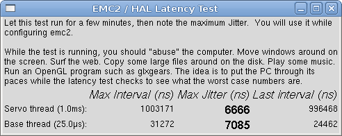

1.3.1 Latency Test
While the test is running, you should "abuse" the computer. Move windows around on the screen. Surf the web. Copy some large files around on the disk. Play some music. Run an OpenGL program such as glxgears. The idea is to put the PC through its paces while the latency test checks to see what the worst case numbers are. Do not run EMC2 while the latency test is running. Run the test at least a few minutes or longer.
Figure: Latency Test
Latency is how long it takes the PC to stop what it is doing and respond to an external request. In our case, the request is the periodic "heartbeat" that serves as a timing reference for the step pulses. The lower the latency, the faster you can run the heartbeat, and the faster and smoother the step pulses will be.
Latency is far more important than CPU speed. The CPU isn't the only factor in determining latency. Motherboards, video cards, USB ports, SMI issues, and a number of other things can hurt the latency.
The important numbers are the "max jitter". In the example above 7085 nanoseconds is the highest jitter. Record this number, and enter it in the Base Period Maximum Jitter box.
If your Max Jitter number is less than about 15-20 microseconds (15000-20000 nanoseconds), the computer should give very nice results with software stepping. If the max latency is more like 30-50 microseconds, you can still get good results, but your maximum step rate might be a little disappointing, especially if you use microstepping or have very fine pitch leadscrews. If the numbers are 100uS or more (100,000 nanoseconds), then the PC is not a good candidate for software stepping. Numbers over 1 millisecond (1,000,000 nanoseconds) mean the PC is not a good candidate for EMC, regardless of whether you use software stepping or not.

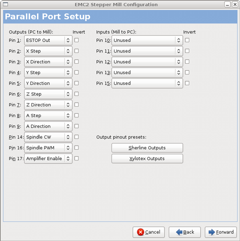

1.4 Parallel Port Setup
Figure: Parallel Port Setup Page
For each pin, choose the signal which matches your parallel port pin out. Turn on the "invert" check box if the signal is inverted (0V for true/active, 5V for false/inactive).
- Output pinout presets
- Automatically set pins 2 through 9 according to the Sherline standard (Direction on pins 2, 4, 6, 8) or the Xylotex standard (Direction on pins 3, 5, 7, 9).
- Inputs and Outputs
- If the input or output is not used set the option to "Unused".
Charge Pump If your driver board requires a charge pump signal simply select Charge Pump from the drop down list for the output pin you wish to connect to your charge pump input. The charge pump output is connected to the base thread by Stepconf. The charge pump output will be about 1/2 of the maximum step rate shown on the Basic Machine Configuration page.

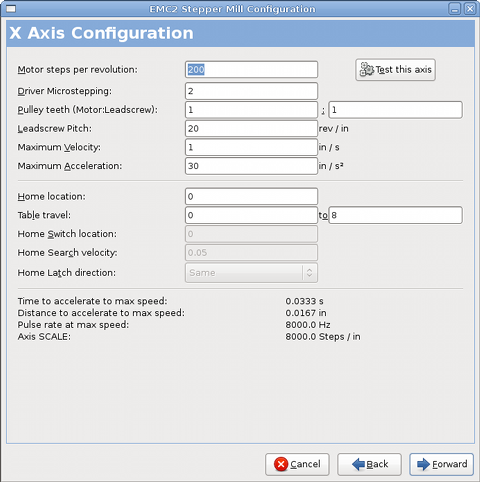

1.5 Axis Configuration
Figure: Axis Configuration Page- Motor Steps Per Revolution
- The number of full steps per motor revolution. If you know how many degrees the motor is (e.g., 1.2 degree), then divide 360 by the degrees to find the number of steps per motor revolution.
- Driver Microstepping
- The amount of microstepping performed by the driver. Enter "2" for half-stepping.
- Pulley Ratio
- If your machine has pulleys between the motor and leadscrew, enter the ratio here. If not, enter "1:1".
- Leadscrew Pitch
- Enter the pitch of the leadscrew here. If you chose "Inch" units, enter the number of threads per inch here (e.g., enter 8 for 8TPI). If you chose "mm" units, enter the number of millimeters per thread here (e.g., enter 2 for 2mm/rev). If the machine travels in the wrong direction, enter a negative number here instead of a positive number or invert the direction pin for the axis.
- Maximum Velocity
- Enter the maximum velocity for the axis in units per second.
- Maximum Acceleration
- The correct values for these items can only be determined through experimentation. See "Finding Velocity and Acceleration" below.
- Home Location
- The position the machine moves to after completing the homing procedure for this axis. For machines without home switches, this is the location the operator manually moves the machine to before pressing the Home button. If you combine the home and limit switches you must move off of the switch to the home position or you will get a joint limit error.
- Table Travel
- The range of travel that g code programs must not exceed. The home location must be inside the Table Travel. In particular, having Home Location exactly equal to one of the Table Travel values is incorrect configuration
- Home Switch Location
- The location at which the home switch trips or releases during the homing process. This item and the two below only appear when Home Switches were chosen in the Parallel Port Pinout. If you combine home and limit switches the home switch location can not be the same as the home position or you will get a joint limit error.
- Home Search Velocity
- The velocity to use when moving towards the switch. If the switch is near the end of travel, this velocity must be chosen so that the axis can decelerate to a stop before hitting the end of travel. If the switch is only closed for a short range of travel (instead of being closed from its trip point to one end of travel), this velocity must be chosen so that the axis can decelerate to a stop before the switch opens again, and homing must always be started from the same side of the switch.
If the machine moves the wrong direction at the beginning of the homing procedure, negate the value of Home Search Velocity. - Home Latch Direction
- Choose "Same" to have homing back off the switch, then approach it again at a very low speed. The second time the switch closes, the home position is set.
Choose "Opposite" to have homing slowly back off the switch. When the switch opens, the home position is set. - Time to accelerate to max speed
- Distance to accelerate to max speed
- Pulse rate at max speed
- Information computed based on the values entered above. The greatest Pulse rate at max speed determines the BASE_PERIOD, and values above 20000Hz may lead to slow response time or even lockups (the fastest usable pulse rate varies from computer to computer)
- Axis SCALE:
- The number that will be used in the ini file [SCALE] setting. This is how many steps per user unit.
- Test this axis
- This will open a window to allow testing for each axis. This can be used after filling out all the information for this axis.

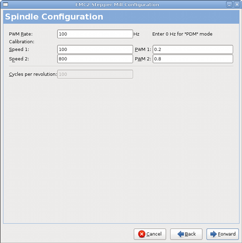

1.6 Spindle Configuration
Figure: Spindle Configuration Page
This page only appear when "Spindle PWM" is chosen in the Parallel Port Pinout page for one of the outputs.
1.6.0.1 Spindle Speed Control
If "Spindle PWM" appears on the pinout, the following information should be entered:
- PWM Rate
- The "carrier frequency" of the PWM signal to the spindle. Enter "0" for PDM mode, which is useful for generating an analog control voltage. Refer to the documentation for your spindle controller for the appropriate value.
- Speed 1 and 2, PWM 1 and 2
- The generated configuration file uses a simple linear relationship to determine the PWM value for a given RPM value. If the values are not known, they can be determined. For more information see section ([.])
1.6.0.2 Spindle-synchronized motion (lathe threading)
When the appropriate signals from a spindle encoder are connected to the parallel port, EMC supports lathe threading. These signals are:
- Spindle Index
- Is a pulse that occurs once per revolution of the spindle.
- Spindle Phase A
- This is a pulse that occurs in multiple equally-spaced locations as the spindle turns.
- Spindle Phase B
- (optional) This is a second pulse that occurs, but with an offset from Spindle Phase A. The advantages to using both A and B are increased noise immunity and increased resolution.
If "Spindle Phase A" and "Spindle Index" appear on the pinout, the following information should be entered:
- Cycles per revolution
- The number of cycles of the Spindle A signal during one revolution of the spindle. This option is only enabled when an input has be set to "Spindle Phase A"
1.6.1 Determining Spindle Calibration
Enter the following values in the Spindle Configuration page:
Speed 1: |
0 |
PWM 1: |
0 |
Speed 2: |
1000 |
PWM 1: |
1 |
Finish the remaining steps of the configuration process, then launch EMC with your configuration. Turn the machine on and select the MDI tab. Start the spindle turning by entering: M3 S100. Change the spindle speed by entering a different S-number: S800. Valid numbers range from 1 to 1000.
For two different S-numbers, measure the actual spindle speed in RPM. Record the S-numbers and actual spindle speeds. Run Stepconf again. For "Speed" enter the measured speed, and for "PWM" enter the S-number divided by 1000.
Because most spindle drivers are somewhat nonlinear in their response curves, it is best to:
- Make sure the two calibration speeds are not too close together in RPM
- Make sure the two calibration speeds are in the range of speeds you will typically use while milling
For instance, if your spindle will go from 0RPM to 8000RPM, but you generally use speeds from 400RPM to 4000RPM, then find the PWM values that give 1600RPM and 2800RPM.

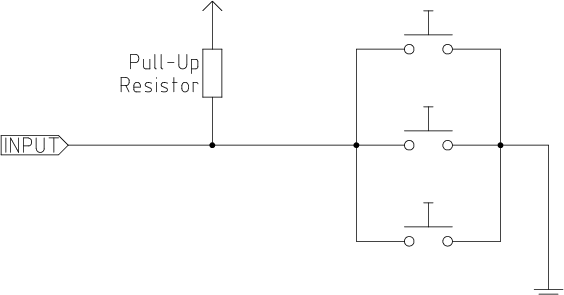

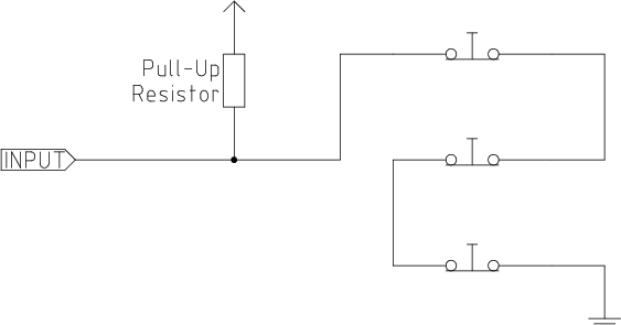

1.10 Home and Limit Switch wiring options
The ideal wiring for external switches would be one input per switch. However, the PC parallel port only offers a total of 5 inputs, while there are as many as 9 switches on a 3-axis machine. Instead, multiple switches are wired together in various ways so that a smaller number of inputs are required.
The figures below show the general idea of wiring multiple switches to a single input pin. In each case, when one switch is actuated, the value seen on INPUT goes from logic HIGH to LOW. However, EMC expects a TRUE value when a switch is closed, so the corresponding "Invert" box must be checked on the pinout configuration page.
![](switch-nc-series.png)
Wiring N/C switches in series (simplified diagram)

Wiring N/O switches in parallel (simplified diagram)
Figure: Normally Open Switches
The following combinations of switches are permitted in Stepconf:
- Combine home switches for all axes
- Combine limit switches for all axes
- Combine both limit switches for one axis
- Combine both limit switches and the home switch for one axis
- Combine one limit switch and the home switch for one axis
The last two combinations are also appropriate when a "home to limit" is used.
