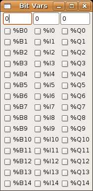

1.4.1 The Variables window
It displays some of the variable data and variable names. Notice all variable start with the % sign.
The three edit areas at the top allow you to select what 15 variable will be displayed in each column. For instance if there were 30 %I variable and you entered 10 at the top of the column, variable %I10 to %I25 would be displayed.
The check boxes allow you to set and un set variables but when classicladder is running hal will update the pins and change them.
Near the bottom are the %W variables. These are called word variable and represent positive and negative (signed) numbers and are used with compare and operate. By clicking on the variable, you can edit the number to display which ever you want.The edit box beside it is the number stored in the variable -you can change it- and the drop-down box beside that allow you to choose whether the number to be displayed is in hex, decimal or binary.
The %I variable represents HAL input bit pins. The %Q represents the relay coil and HAL output bit pins. The %B represents an internal relay coil or internal contact.
Figure: ClassicLadder Var window

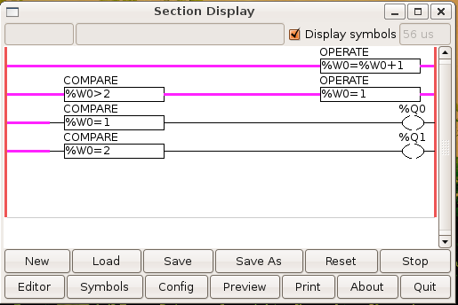

1.4.2 The Section Display window
Most of the buttons are self explanitory:
The config button is not used in EMC.
The symbols button will display an editable list of symbols for the variables (eg you can name the inputs, outputs, coils etc).
The symbols window will display the HAL signal names if present for %I, %Q and %W variables.
The quit button will only shut down the display-the ladder program will still run in the back ground.
The check box at the top right allows you to select whether variable names or symbol names are displayed
Figure: ClassicLadder Section Display window

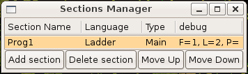

1.4.3 The Section Manager window
This window allows you to name, create or delete sections. This is also how you name a subroutine for call coils.
Figure: ClassicLadder Section Manager window

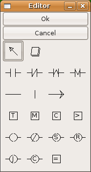

1.4.4 The Editor window
Starting from the top left image:
  1. SELECTOR ARROW, ERASER
  2. N.O., N.C. , RISING-EDGE ,FALLING-EDGE CONTACTS.
  3. HORIZONTAL, VERTICAL , HORIZONTAL RUNNING-CONNECTIONS
  4. TIMER, MONOSTABLE, COUNTER, COMPARE
  5. N.O. COIL, N.C. COIL, SET COIL, RESET COIL
  6. JUMP COIL, CALL COIL, OPERATE
Figure: ClassicLadder Editor window
A short description of each of the buttons:
