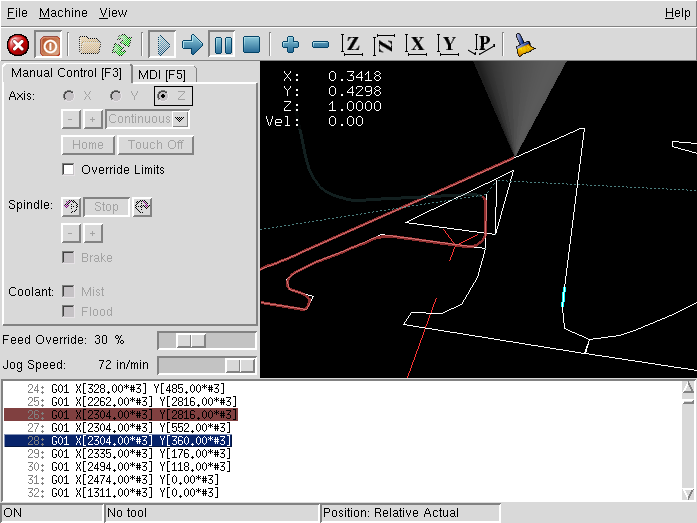

When you start AXIS, a window like the one in Figure [.] is shown.
The AXIS window contains the following elements:

In the upper-left corner of the program display is the coordinate display. It shows the position of the machine. To the left of the axis name, an origin symbol (
) is shown if the axis has been properly homed. To the right of the axis name, a limit symbol (
) is shown if the axis is on one of its limit switches.
To properly interpret these numbers, refer to the “Position:” indicator in the status bar. If the position is “Absolute”, then the displayed number is in the machine coordinate system. If it is “Relative”, then the displayed number is in the offset coordinate system. When the coordinates displayed are relative, the display will include a cyan “machine origin” marker (
). If the position is “Commanded”, then it is the ideal position--for instance, the exact coordinate given in a G0 command. If it is “Actual”, then it is the position the machine has actually been moved to. These values can differ for several reasons: Following error, deadband, encoder resolution, or step size. For instance, if you command a movement to X 0.0033 on your mill, but one step of your stepper motor is 0.00125, then the “Commanded” position will be 0.0033 but the “Actual” position will be 0.0025 (2 steps) or 0.00375 (3 steps).
When a file is loaded, a preview of it is shown in the display area. Fast moves (such as those produced by the G0 command) are shown as dotted green lines. Moves at a feed rate (such as those produced by the G1 command) are shown as solid white lines. Dwells (such as those produced by the G4 command) are shown as small “X” marks.
The “extents” of the program in each axis are shown. At each end, the least or greatest coordinate value is indicated. In the middle, the difference between the coordinates is shown. In Figure ([.]), the X extent of the file is from 0.00 to 6.92 inches, a total of 6.92 inches.
When some coordinates exceed the “soft limits” in the .ini file, the relevant dimension is shown in a different color and enclosed by a box. In Figure ([.]) the maximum soft limit is exceeded on the X axis as indicatated by the box surrounding the coordinate value.
The location of the tip of the tool is indicated by the “tool cone”. The cone does not indicate anything about the shape, length, or radius of the tool.
When a tool is loaded (for instance, with the MDI command T1M6), the cone changes to a cylinder which shows the diameter of the tool given in the tool table file.
When the machine moves, it leaves a trail called the backplot. The color of the line indicates the type of motion: Yellow for jogs, faint green for rapid movements, red for straight moves at a feed rate, and magenta for circular moves at a feed rate.
By left-clicking on a portion of the preview plot, the line will be highlighted in both the graphical and text displays. By left-clicking on an empty area, the highlighting will be removed.
By dragging with the left mouse button pressed, the preview plot will be shifted (panned).
By dragging with shift and the left mouse button pressed, or by dragging with the mouse wheel pressed, the preview plot will be rotated. When a line is highlighted, the center of rotation is the center of the line. Otherwise, the center of rotation is the center of the file as a whole.
By rotating the mouse wheel, or by dragging with the right mouse button pressed, or by dragging with control and the left mouse button pressed, the preview plot will be zoomed in or out.
By clicking one of the “Preset View” icons, or by pressing “V”, several preset views may be selected.
Figure: Current and Selected LinesBy left-clicking a line of the program, the line will be highlighted in both the graphical and text displays.
When the program is running, the line currently being executed is highlighted in red. If no line has been selected by the user, the text display will automatically scroll to show the current line.

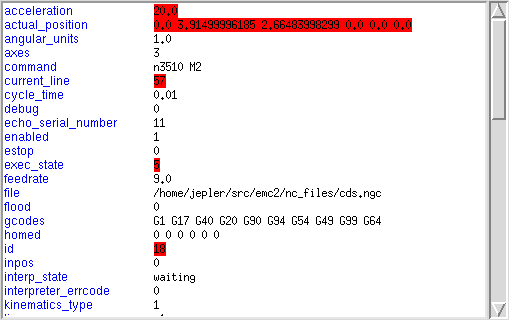

AXIS includes a program called “emctop” which shows some of the details of EMC's state. You can run this program by invoking Machine > Show EMC Status
Figure: EMC Status WindowThe name of each item is shown in the left column. The current value is shown in the right column. If the value has recently changed, it is shown on a red background.
