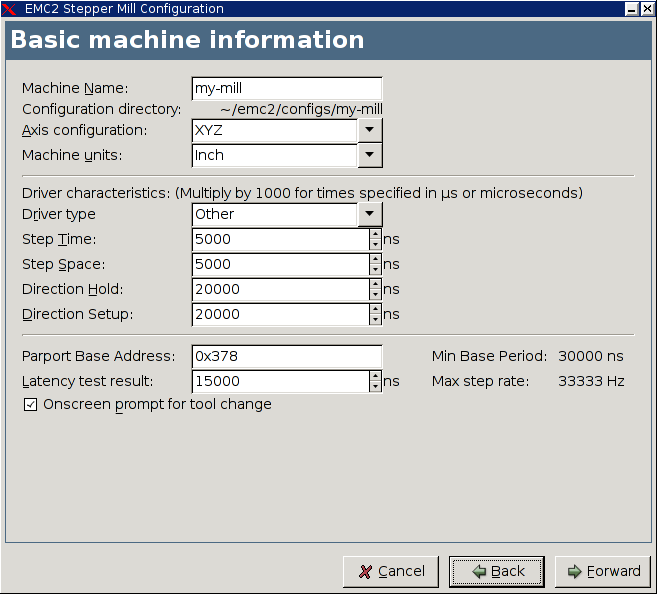

5.1.1 Basic Information
Figure: Basic Information Page
Machine Name
Choose a name for your machine. Use only uppercase letters, lowercase letters, digits, “-” and “_”.
Axis Configuration
Choose XYZ (Mill), XYZA (4-axis mill) or XZ (Lathe).
Machine Units
Choose Inch or mm. All subsequent questions (such as machine travel, leadscrew pitch, etc) will be answered in the chosen units
Driver Type
If you have one of the stepper drivers listed in the pull down box, choose it. Otherwise, find the 4 timing values in your driver's data sheet and enter them. If the data sheet gives a value in microseconds, multiply by 1000. For example, enter 4.5us as 4500. The Gecko type is for the 201 drive. A list is on the wiki site of most popular drives with the timing values is in the Stepper Drive Timing Page.
Additional signal conditioning or isolation such as optocouplers and RC filters on break out boards can impose timing constraints of their own, in addition to those of the driver. You may find it necessary to add some time to the drive requirements to allow for this.
Latency Test Result
Enter the result of the Latency Test here. To run a latency test see section ([.])
Max Step Rate
Stepconf automatically calculates the Max Step Rate based on the driver characteristics entered and the latency test results.
Min Base Period
Stepconf automatically determines the Min Base Period based on the driver characteristics entered and latency test result.
Onscreen Prompt For Tool Change
If this box is checked, EMC will pause and prompt you to change the tool when M6 is encountered. Leave this box checked unless you plan to add support for an automatic tool changer in a custom hal file

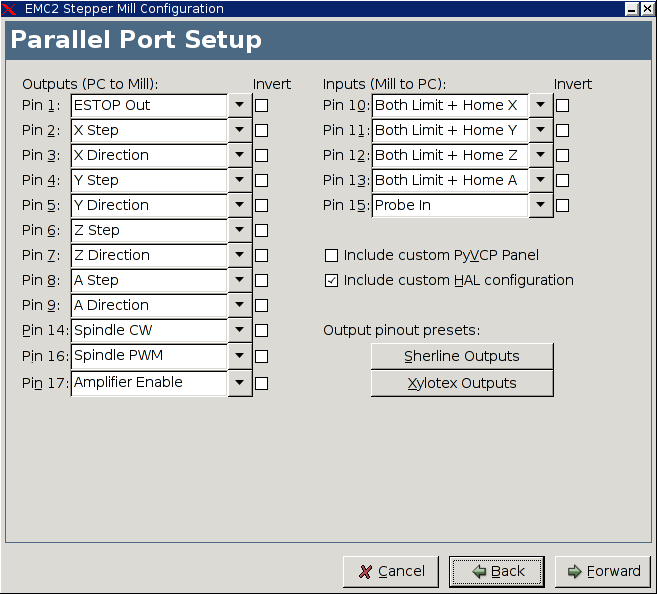

5.1.2 Parallel Port Setup
Figure: Parallel Port Setup Page
For each pin, choose the signal which matches your parallel port pin out. Turn on the “invert” check box if the signal is inverted (0V for true/active, 5V for false/inactive).
Output pinout presets
Automatically set pins 2 through 9 according to the Sherline standard (Direction on pins 2, 4, 6, 8) or the Xylotex standard (Direction on pins 3, 5, 7, 9).
Inputs and Outputs
If the input or output is not used set the option to “Unused”.
Include custom HAL configuration
Allows you to add additional hal customizations in the file custom.hal after running Stepconf.
Include custom PyVCP Panel If selected, the PyVCP control panel panel.xml will be displayed on the right-hand side of the main AXIS window. This will not create a PyVCP panel but will create the blank file in the config folder. To create a PyVCP panel see the PyVCP section of the Integrators Manual.
Charge Pump If your driver board requires a charge pump signal simply select Charge Pump from the drop down list for the output pin you wish to connect to your charge pump input. The charge pump output is connected to the base thread by Stepconf. The charge pump output will be about 1/2 of the maximum step rate shown on the Basic Machine Configuration page.

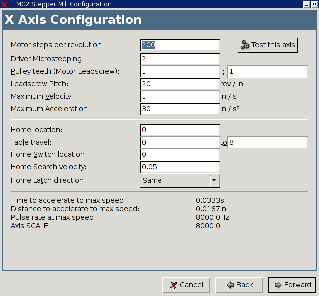

5.1.3 Axis Configuration
Figure: Axis Configuration Page
Motor Steps Per Revolution
The number of full steps per motor revolution. If you know how many degrees the motor is (e.g., 1.2 degree), then divide 360 by the degrees to find the number of steps per motor revolution.
Driver Microstepping
The amount of microstepping performed by the driver. Enter “2” for half-stepping.
Pulley Ratio
If your machine has pulleys between the motor and leadscrew, enter the ratio here. If not, enter “1:1”.
Leadscrew Pitch
Enter the pitch of the leadscrew here. If you chose “Inch” units, enter the number of threads per inch here (e.g., enter 8 for 8TPI). If you chose “mm” units, enter the number of millimeters per thread here (e.g., enter 2 for 2mm/rev). If the machine travels in the wrong direction, enter a negative number here instead of a positive number.
Maximum Velocity
Enter the maximum velocity for the axis in units per second.
Maximum Acceleration
The correct values for these items can only be determined through experimentation. See “Finding Velocity and Acceleration” below.
Home Location
The position the machine moves to after completing the homing procedure for this axis. For machines without home switches, this is the location the operator manually moves the machine to before pressing the Home button.
Table Travel
The range of travel that gcode programs must not exceed. The home location must be inside the Table Travel. In particular, having Home Location exactly equal to one of the Table Travel values is incorrect configuration
Home Switch Location
The location at which the home switch trips or releases during the homing process. This item and the two below only appear when Home Switches were chosen in the Parallel Port Pinout.
Home Search Velocity
The velocity to use when moving towards the switch. If the switch is near the end of travel, this velocity must be chosen so that the axis can decelerate to a stop before hitting the end of travel. If the switch is only closed for a short range of travel (instead of being closed from its trip point to one end of travel), this velocity must be chosen so that the axis can decelerate to a stop before the switch opens again, and homing must always be started from the same side of the switch.
If the machine moves the wrong direction at the beginning of the homing procedure, negate the value of Home Search Velocity.
Home Latch Direction
Choose “Same” to have homing back off the switch, then approach it again at a very low speed. The second time the switch closes, the home position is set.
Choose “Opposite” to have homing slowly back off the switch. When the switch opens, the home position is set.
Time to accelerate to max speed
Distance to accelerate to max speed
Pulse rate at max speed
Information computed based on the values entered above. The greatest Pulse rate at max speed determines the BASE_PERIOD, and values above 20000Hz may lead to slow response time or even lockups (the fastest usable pulse rate varies from computer to computer)
Test this axis
This will open a window to allow testing for each axis. See section ([.])

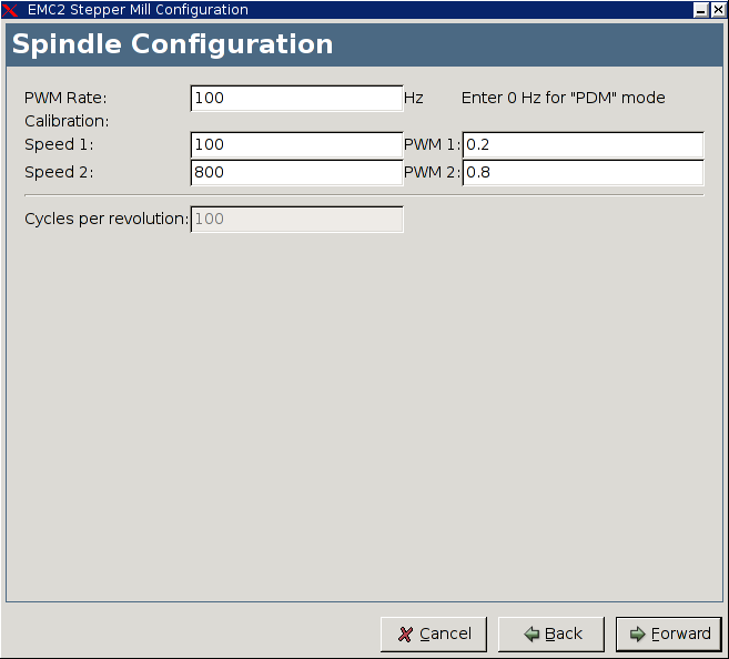

5.1.4 Spindle Configuration
Figure: Spindle Configuration Page
These options only appear when “Spindle PWM”, “Spindle A” or “Spindle PPR” are chosen in the Parallel port pinout.
5.1.4.1 Spindle Speed Control
If “Spindle PWM” appears on the pinout, the following information should be entered:
PWM Rate
The “carrier frequency” of the PWM signal to the spindle. Enter “0” for PDM mode, which is useful for generating an analog control voltage. Refer to the documentation for your spindle controller for the appropriate value.
Speed 1 and 2, PWM 1 and 2
The generated configuration file uses a simple linear relationship to determine the PWM value for a given RPM value. If the values are not known, they can be determined. For more information see section ([.])
