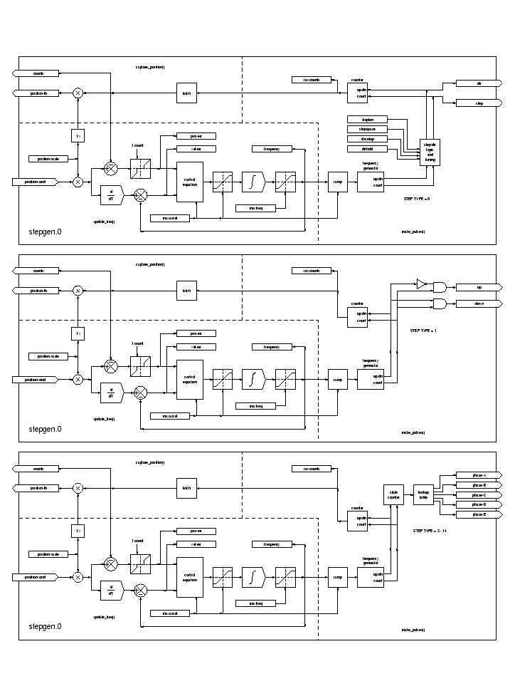

This component provides software based generation of step pulses in
response to position commands. It has a built in pre-tuned position
loop, so PID tuning is not required. This component is strongly recommended
for stepper based EMC machines, since it eliminates the need to use
(and tune) a separate PID loop. It is a realtime component only, and
depending on CPU speed, etc, is capable of maximum step rates of 10kHz
to perhaps 50kHz. Figure
shows three
block diagrams, each is a single step pulse generator. The first diagram
is for step type '0', (step and direction). The second is for step
type '1' (up/down, or pseudo-PWM), and the third is for step types
2 through 14 (various stepping patterns).
Figure:
Step Pulse Generator Block Diagram

The values of maxfreq and maxaccel are used by the internal position
loop to avoid generating step pulse trains that the motor cannot follow.
When set to values that are appropriate for the motor, even a large
instantaneous change in commanded position will result in a smooth
trapezoidal move to the new location. The algorithm works by measuring
both position error and velocity error, and calculating an acceleration
that attempts to reduce both to zero at the same time. For more details,
including the contents of the ``control equation'' box, consult
the code.

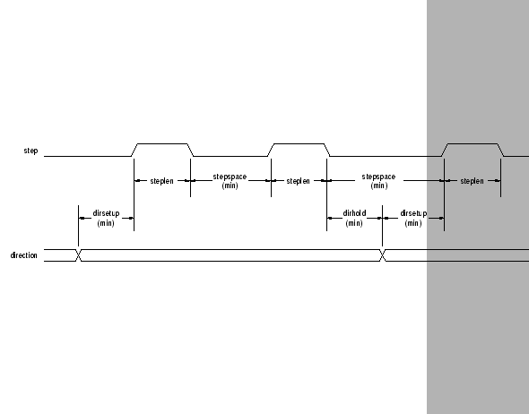

Step Types
The step generator supports 15 different ``step types''. Step
type 0 is the most familiar, standard step and direction. When configured
for step type 0, there are four extra parameters that determine the
exact timing of the step and direction signals. See figure
for the meaning of these parameters. The parameters are integers,
and represent a number of calls to make_pulses(). For example,
if make_pulses() is called every 16uS, and steplen is 2,
then the step pulses will be 2 x 16 = 32uS long. The default value
for all four of the parameters is 1. Since one step requires steplen
periods high and stepspace periods low, the maximum frequency
is the thread frequency divided by (steplen+stepspace). If
maxfreq is set higher than that limit, it will be lowered
automatically. If maxfreq is zero, it will remain zero, but the output
frequency will still be limited.
Figure:
Step and Direction Timing

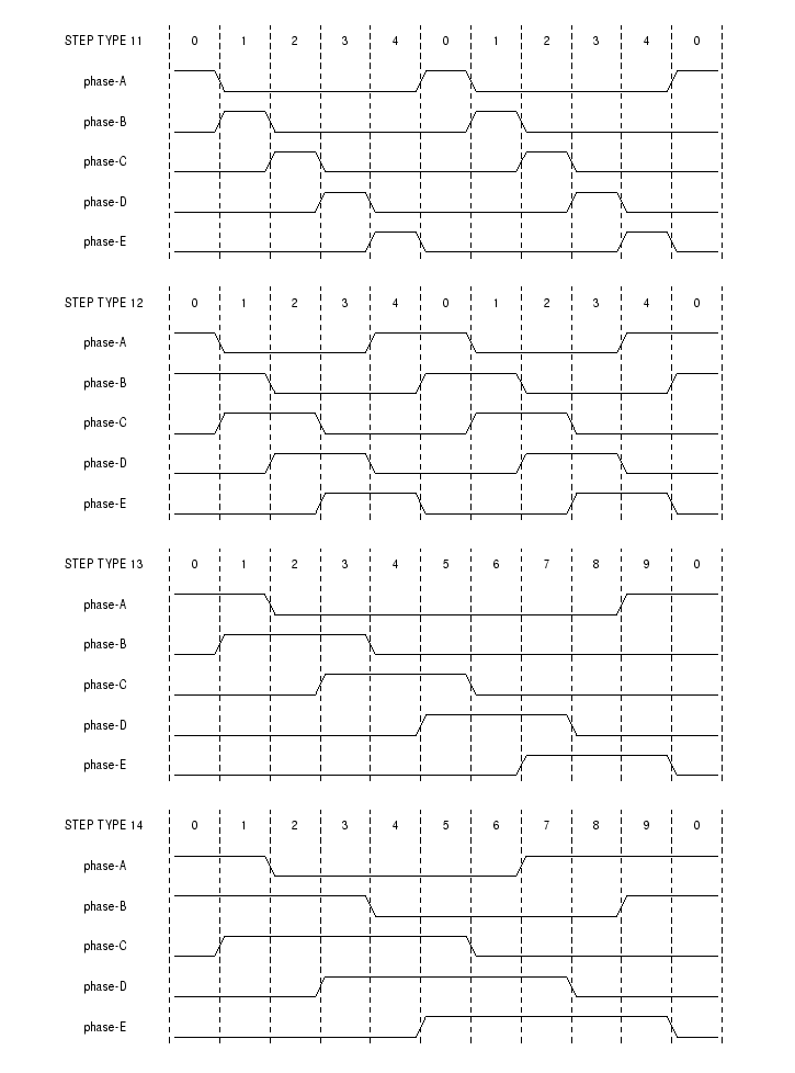

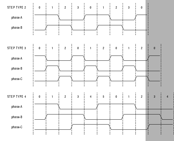

Step types 2 through 14 are state based, and have from two to five
outputs. On each step, a state counter is incremented or decremented.
Figures
, and
show the output patterns as a function of the state counter. The maximum
frequency is the same as the thread rate, and as in the other modes,
maxfreq will be lowered if it is above the limit.
Figure:
Quadrature and Three Phase Step Types
Figure:
Four-Phase Step Types
Figure:
Five-Phase Step Types

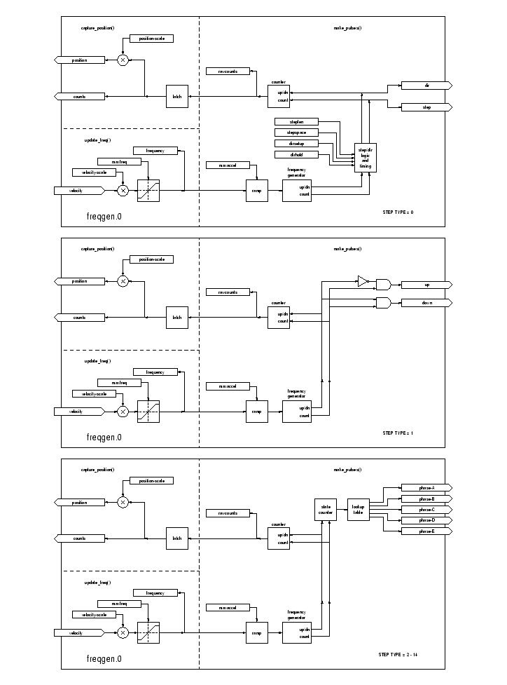

Freqgen
This component provides software based generation of step pulses from
a frequency or velocity command. EMC normally uses position commands,
not velocity commands, and stepgen (described in section
is more appropriate. However, there may be applications where velocity
based pulses are needed. One such application is using step type 1
as a pseudo-PWM output. Combined with a PID loop. the software encoder
counter module, and a simple H-bridge, this has been used to run small
DC servomotors, however now that the pwmgen component has been added,
it is a better choice for this purpose. Another possible use for freqgen
is to simply spin a stepper motor at a constant (or adjustable) rate,
while ignoring position. Freqgen uses the same pulse generator core
as stepgen, however it has no position loop. It is a realtime component
only, and depending on CPU speed, etc, is capable of maximum step
rates of 10kHz to perhaps 50kHz. Figure
shows three block diagrams, each is a single step pulse generator.
The first diagram is for step type '0', (step and direction). The
second is for step type '1' (up/down, or pseudo-PWM), and the third
is for step types 2 through 14 (various stepping patterns).
Figure:
