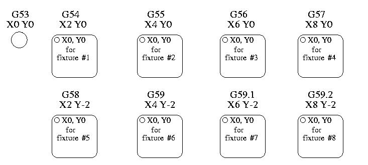

Work or fixture offset are used to make a part home that is different
from the absolute, machine coordinate system. This allows the part
programmer to set up home positions for multiple parts. A typical
operation that uses fixture offsets would be to mill multiple copies
of parts on "islands" in a piece, similar to figure
The values for offsets are stored in the VAR file that is requested by the INI file during the startup of an EMC. In our example below we'll use G55. The values for each axis for G55 are stored as variable numbers.

Once there are values assigned, a call to G55 in a program block would
shift the zero reference by the values stored. The following line
would then move each axis to the new zero position. Unlike G53, G54
through G59.3 are modal commands. They will act on all blocks of code
after one of them has been set. The program that might be run using
figure
would require only a single coordinate reference
for each of the locations and all of the work to be done there. The
following code is offered as an example of making a square using the
G55 offsets that we set above.
G55 G0 x0 y0 z0
g1 f2 z-0.2000
x1
y1
x0
y0
g0 z0
g54 x0 y0 z0
m2``But,'' you say, ``why is there a G54 in there near the end.'' Many programmers leave the G54 coordinate system with all zero values so that there is a modal code for the absolute machine based axis positions. This program assumes that we have done that and use the ending command as a command to machine zero. It would have been possible to use g53 and arrive at the same place but that command would not have been modal and any commands issued after it would have returned to using the G55 offsets because that coordinate system would still be in effect.
