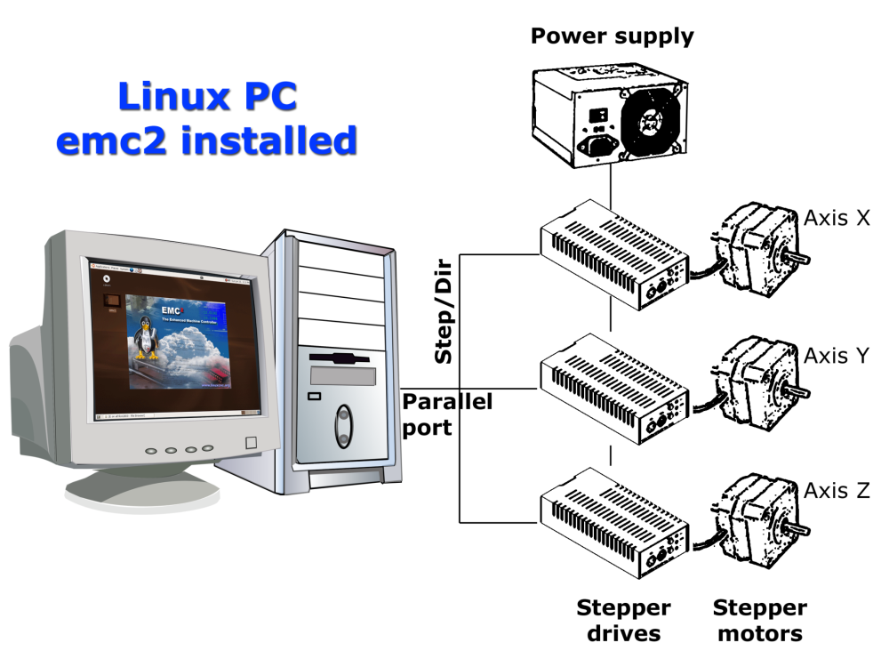

Figure
shows a simple block diagram showing
what a typical 3-axis EMC2 system might look like. This diagram shows
a stepper motor system. The PC, running Linux as its
operating system, is actually controlling the stepper motor drives
by sending signals through the printer port. These signals (pulses)
make the stepper drives move the stepper motors. The EMC2 can also
run servo motors via servo interface cards or by using an extended
parallel port to connect with external control boards. As we examine
each of the components that make up an EMC2 system we will remind
the reader of this typical machine.

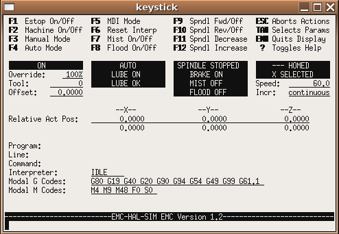

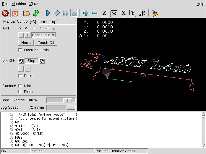

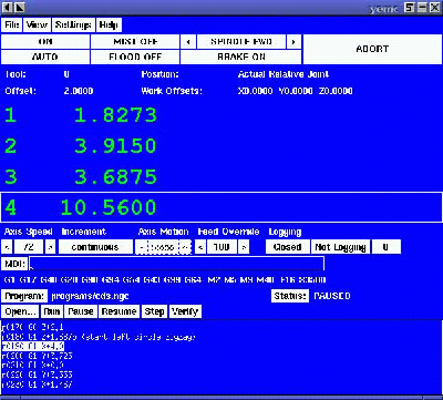

A graphical interface is the part of the EMC2 that the machine tool operator interacts with. The EMC2 comes with several types of user interfaces:
and yemc
and mini
Tkemc and Mini will run on Linux, Mac, and Microsoft Windows if the Tcl/Tk programming language has been installed. The Mac and Microsoft Windows version can connect to a real-time EMC2 running on a Linux machine via a network connection, allowing the monitoring of the machine from a remote location. Instructions for installing and configuring the connection between a Mac or Microsoft Machine and a PC running the EMC2 can be found in the Integrators Handbook.

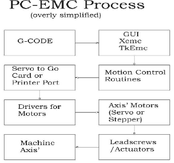

Figure
is a block diagram of how a personal
computer running the EMC2 is used to control a machine with G-code.
The actual G-code can be sent using the MDI (Machine Device
Interface) mode or it can be sent as a file when the machine is in
Auto mode. These choices are made by the operator and
entered using one of the Graphical User Interfaces available with
the software.
G-code is sent to the interpreter which compares the new block with what has already been sent to it. The interpreter then figures out what needs to be done for the motion and input or output systems and sends blocks of canonical commands to the task and motion planning programs.
