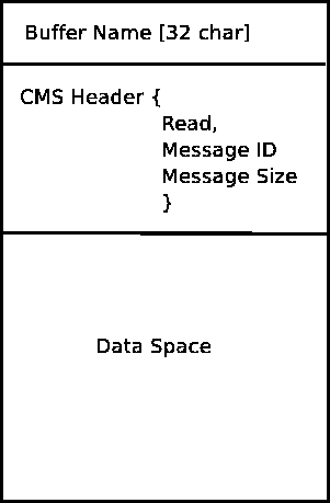

At the heart of libnml is the CMS class, it contains most of the functions used by libnml and ultimately NML. Many of the internal functions are overloaded to allow for specific hardware dependant methods of data passing. Ultimately, everything revolves around a central block of memory (referred to as the ``message buffer'' or just ``buffer''). This buffer may exist as a shared memory block accessed by other CMS/NML processes, or a local and private buffer for data being transfered by network or serial interfaces.
The buffer is dynamically allocated at run time to allow for greater
flexibility of the CMS/NML sub-system. The buffer size must be large
enough to accommodate the largest message, a small amount for internal
use and allow for the message to be encoded if this option is chosen
(encoded data will be covered later). Figure
is an internal view of the buffer space.
The CMS base class is primarily responsible for creating the communications pathways and interfacing to the O.S.

Buffer, Host, Size, Key [TCP/UDP port, queued]
Buffer Name remains - Limited to 32 chars.
Host implies a port number and encoding method.
Size must be defined
key is as well to be user defined.
Port number and queueing option remain, whilst encoding method is implied by the port number - Alternative encodings may return.

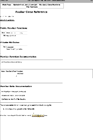

Doxygen is useful in generating documentation from the source code. It has the power to extract comments based on predefined tags. In addition, it can be configured to show inheritance of C++ classes along with call graphs of functions. To aid in producing worthwhile documentation from the emc2 source code, some guidelines on formatting tags and where to place them are suggested.
The final output depends ultimately on the config file used with doxygen. In time, one will be committed to the CVS repository.
These should contain concise descriptions above each function without any formatting tags. Variables contained within class definitions should have a short description on the same line - For example:
int timeout; ///< timeout for blocking semaphore
The '///' informs Doxygen that this comment is to appear in the generated docs, and the '<' indicates the comment refers to the variable or function to the left.
A brief description of each function, parameters, and return values aid other programmers who may work on the code at a later stage. The formatting tags are fairly simple and should appear before the function definition (i.e. Above it). For example:
/*! This gives a short description of Foo(bar, max)
\param bar is the first value
\param max provides a second value
\returns bool TRUE on success or FALSE on failure
bool Foo(int bar, int max)
if (max > bar) {
return true;
return false;
An alternative is:
///! This gives a short description of Bar(foo)
\param foo is the only value
\returns the result, or -1 on failure
int Foo(int foo)
if (max == 0) {
return -1;
return foo;
The resulting document will look like:
